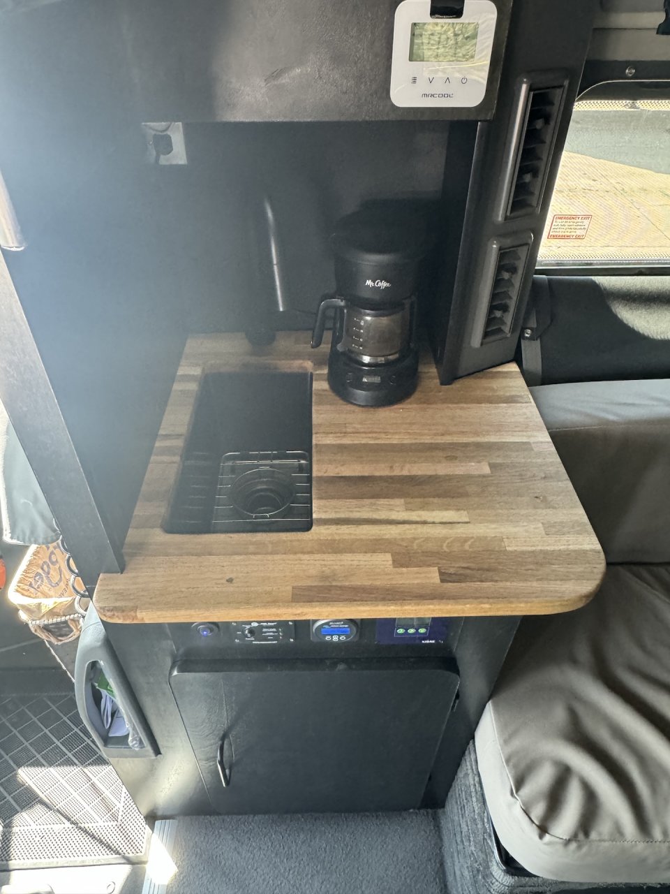

    Next I yanked out the factory closet I never use and put in a cabinet and countertop with a bar sink, 10 gallon water tank, RV water pump and all my controls for APU/power.

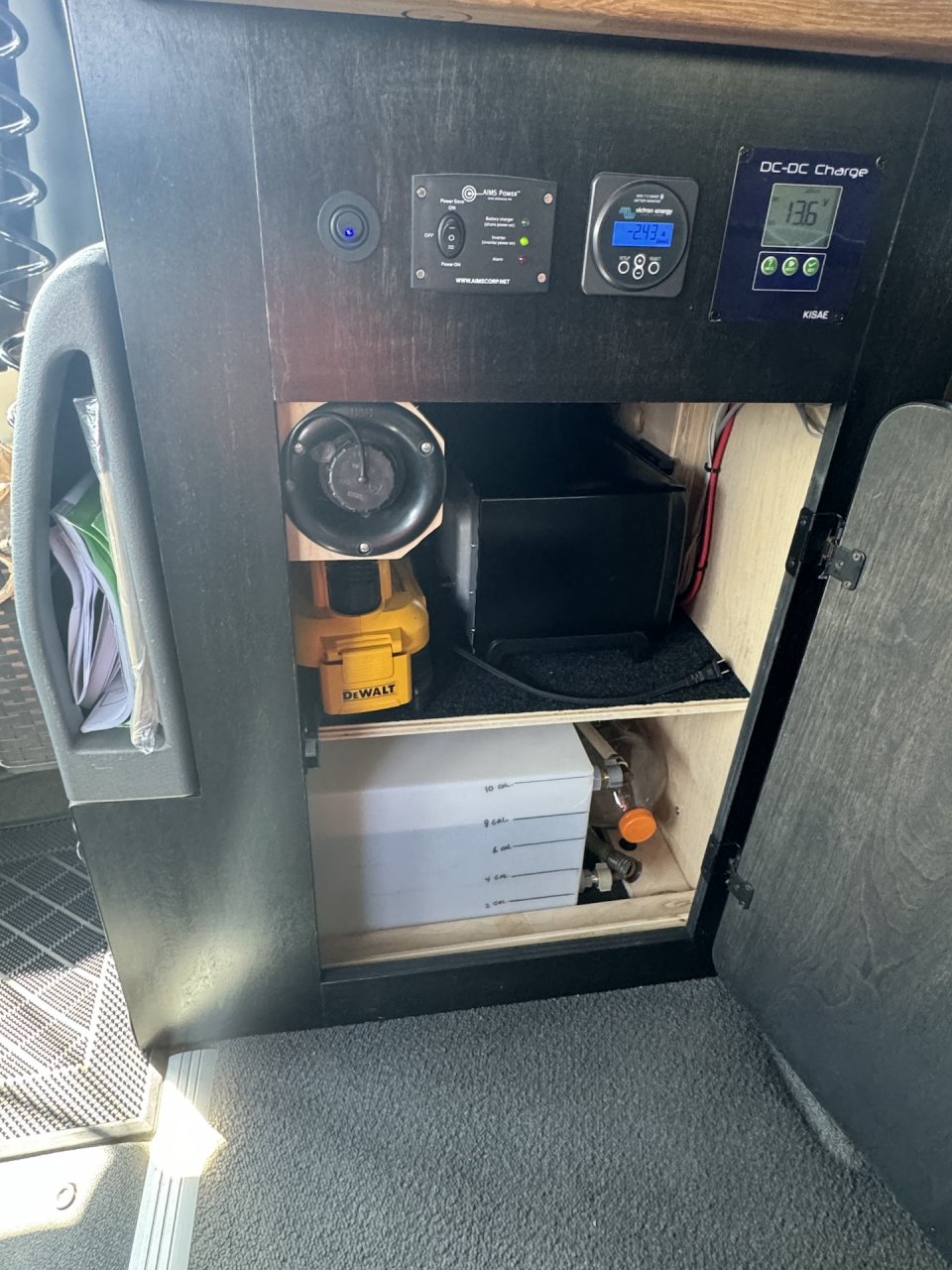

    Next I pulled the upper bunk and added built a U-shaped shelf to hold computer, laser printer, mini split, pantry and my memory foam mattress I use downstairs where I sleep nowadays. Closet, ladder and rear bunk are completely gone. I love the open space.
    Under the driver's side lower bunk I have my DC to DC charger (this charges lithium batteries specifically, from solar or alternator)

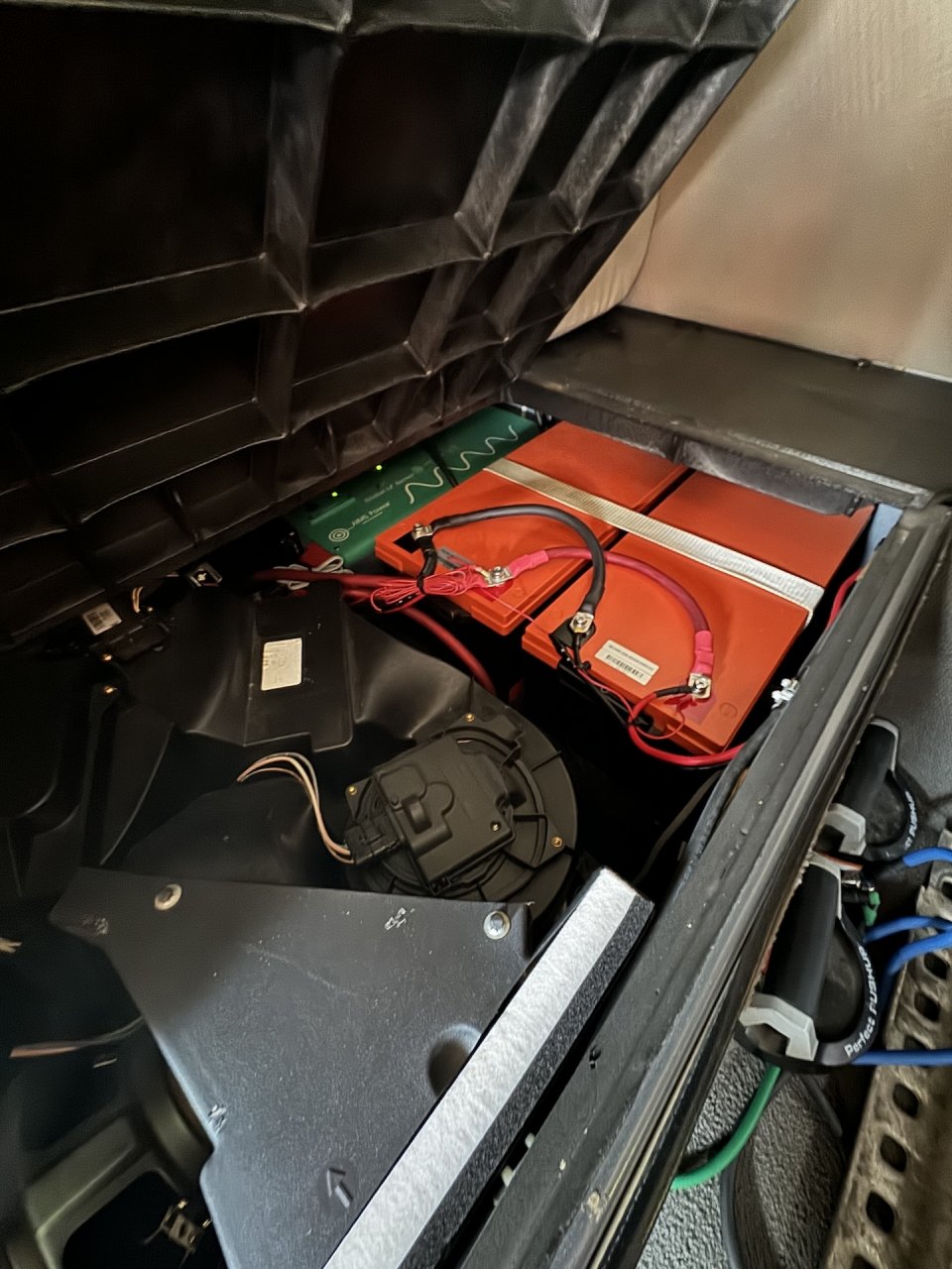

    Passenger side has 560AH of lithium batteries, 2500w pure sine inverter to run the air conditioning and misc. wiring

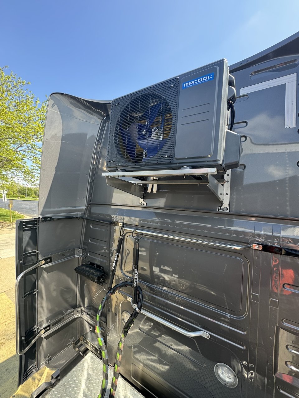

    I painted the Mr. Cool outside unit and mounted it using a stainless steel outdoor mount made for these things. Somebody here recommended it off Amazon. It's super solid but you have to brace the inside of the truck with flat bar or the like. I used some 1' sections of aluminum angle. I think I could hang from it.
    This is a Mr. Cool DIY 9k btu mini split/heat pump. It's just as efficient heating as it is cooling. It's not hot enough outside to test in the summer heat and humidity but overnight so far it will use about 10% of battery bank. I'm expecting this to go way up when it's running steady.
    I have sized the battery system for an easy 12 hrs. of use running and easy recharging from alternator while I drive during the day, currently 40a output on the charger.
    I was worried about condensation drainage from air conditioner when I'm parked tilted the wrong way but these units actually have a drain on either side. I simply had to remove the plug from the other side and add a second drain. You can see the two white insulated drain hoses hanging down under the left side of the unit.
    Way impressed with this unit so far. Almost silent. We'll see how long it takes me to rattle it apart on our lousy roads.

    That's a great looking install on the mini split. Only thing you may consider is securing the top of the condenser to prevent forward/back rocking motion if it isn't totally solid. Or at least check it now and then until you've run with it a while to be comfortable with it. Long story short, I had a problem with that on my son's truck and it cracked one of the hard refrigerant lines right at the fitting. Fixed that and added a piece of flat stainless attaching the top of the unit to the back of the cab using one of the slider rail bolts. That said, the one on my truck is slightly smaller and has been unsecured on the top for two years with no issues.

    After thinking it over a bit more, this right here is the most amazing part of going to a battery powered hvac system. I used to think what an amazing improvement it was going from idling the truck all night to a diesel apu. Now the noise from the diesel apus everywhere sticks out like a sore thumb.
    Going into the 3rd year after 2 of 3 winters exposed to salty conditions up north, barely any change on mine. Just a barely detectable low frequency noise from the condenser unit gets transmitted through the support frame mounts on the cab when the compressor is running.
