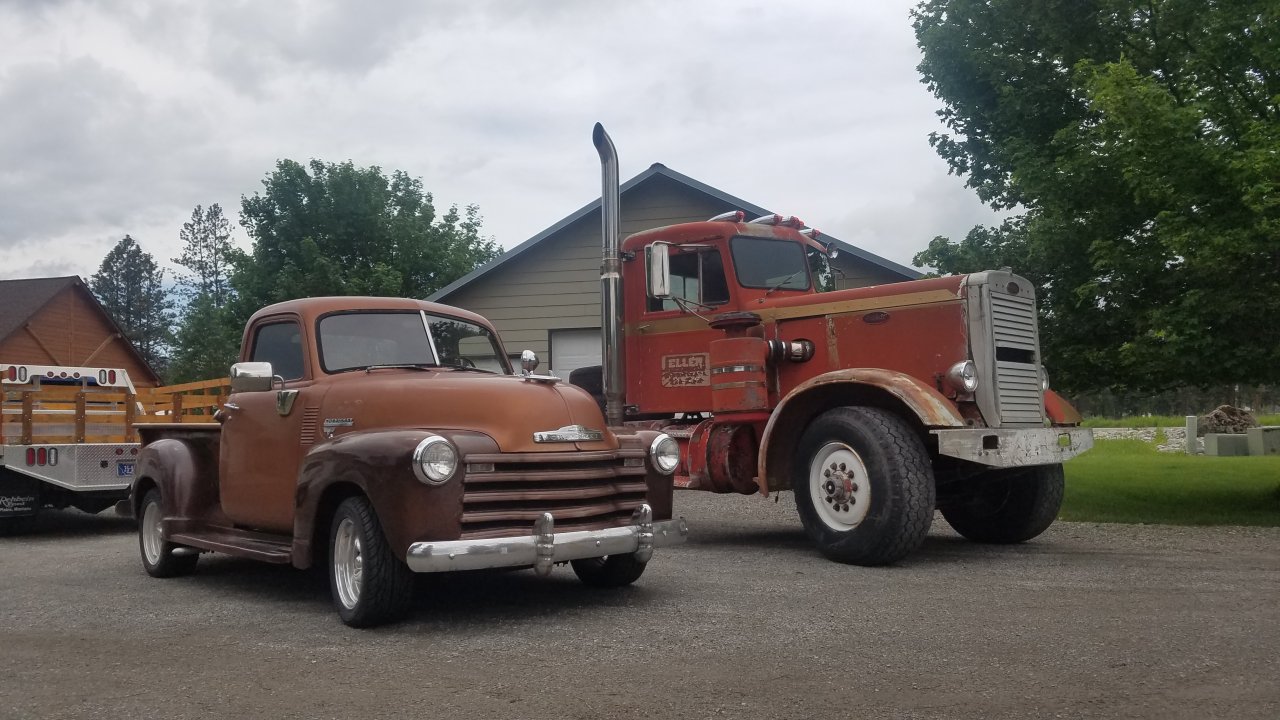

    this peterbilt has that nh 250 cummins in it.

    Yes, thank you im aware that it is an 855 just curious what model of jakes would fir onto it if there is some.

    Model 25A Jake,I believe the 25B will work also.
