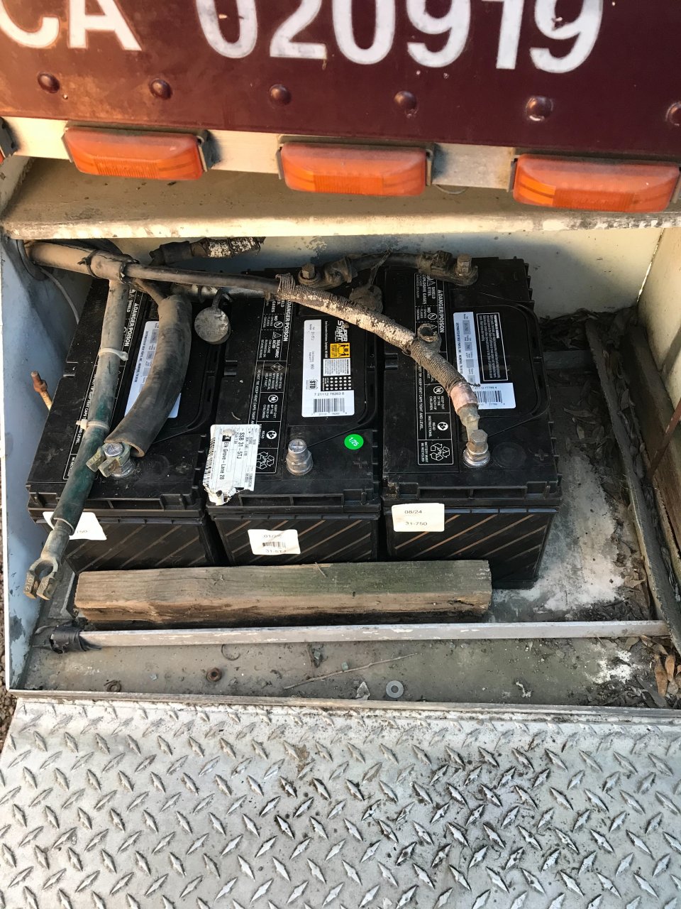

    I was also questioning the Battery/ Voltage set up given the vintage. But when he said everything worked I suspected 12v. Didn’t look like the battery box was set up for 4 batts which from my limited vintage experience most 6 volt series ran 4 batts.
    Keep us posted.

    The OP says it starts and runs well on 5 connections or 12v. 12 will not spin a 24 volt starter.
    If it still had a series parallel switch or solenoid actually is what they are the start button would have a diode in the wire to engage the solenoid and give the starter 24V. If it was still on a series parallel set up the starter would never engage if you jumped it with a button or wire it will hang engaged due to low voltage. I agree it’s of the right vintage. The 6 volt batteries were also more narrow than a 12. However if it was 24 again 12 would not crank it. Not only was the starter motor itself 24 but the solenoid to engage it.
    So the best advice given has been trace the cable back and see where it goes. Is it possible it still has a parallel switch absolutely. Not everyone deletes unnecessary equipment in a change over. It’s also easy to get confused on where a jumper was or wasn’t etc. I’ve seen it multiple times in a battery change. Sometimes by so called mechanics. Thing to remember here is it’s starting on the current 12v

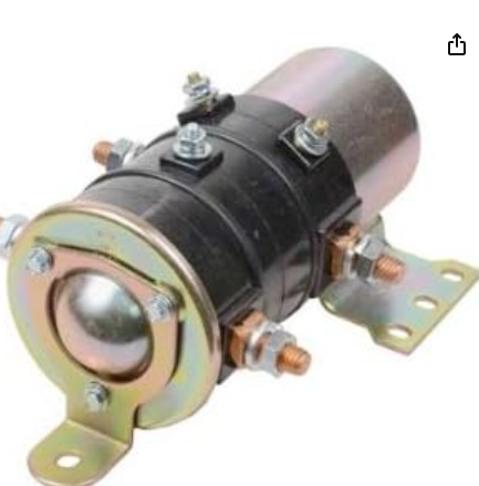

    @Goodysnap is probably correct in post #2 but it would be best to verify.
    Positive is red and goes to the starter solenoid which sits on top of the starter. This is for 12v with no series parallel switch.
    You may have a starter relay which looks like this. Connections go from the battery to the relay then to the starter.
    OR this.
    Series parallel switch looks like this.
    turnerbros Thanks this.
