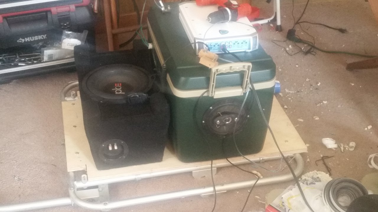

    It's a Rockville "RXM-F3" Marine Amp. It's supposed to be for a car, but I'm using it as a bicycle towed, PA/Sound system.
    Here's a couple of pics of my build...
