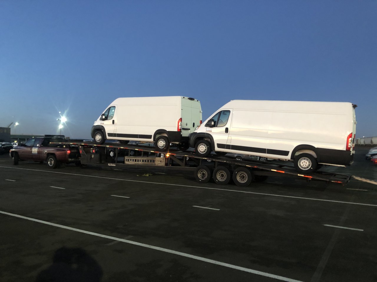

    I have a flat bed 35ft trailer but I haven’t really used it sense I bought the 3 car wedge (it’s for sale if anyone’s interested). Only load board I pay for is central dispatch. Tried DAT for a free trial but never even booked a load off their. Why do you say flatbed for maximized income. It seems you must have the ability to haul heavy with a flatbed to earn a decent buck (more heavy then a 1 ton can handle). As far as repairs go I don’t mind getting dirty with a wrench if I have to. I’m not gonna claim my truck never needed repairs but for the most part it was just wear parts I was replacing. 1 auto transmission rebuild done at 160k miles when stock converter started getting weak. Rebuild has been holding like a champ and cost me about $2500. I installed it myself. Just recently bought a slightly used 2017 ram, hopefully it’ll be as reliable as my old when. Which I still have, couldn’t let it go because it’s just been to good to me.

    That’s the kind of flatbed I have. It’s designed to haul cars but I’ve moved tractors, scissor lifts and even a couple of fiberglass front ends off of semis before. However I don’t understand why people say the wedge trailer are not safe. Your not in a race car. Don’t try going around a turn as fast as possible and you’ll be fine. You have to be smooth with the steering like you should always be. As far as picks up vs semis, each has its benefits. A set of tires for a pick up will run you about the same as 1 semi tire. Sure you will get more miles out of semi tires but I’ve managed to squeeze 60k out of a set of tires on my pick ups. My oil changes are only 3 gallons and dodge recommends changing every 15k I don’t, 5k and it gets a oil change. Breaks also don’t last as long as semis but I’m sure mines last longer then some company driver in a semi (it’s how you drive). Also you can get a new pick up for around 50k, what’s a new semi cost? From talking to other drivers and operators dry van freight is really cheap right now and I’m able to get over $2 a mile but my long term average has been around 1.80cpm
    Like I said each has their own pros and cons and what might work for someone might not work for someone else. But I’ve researched this and talked to other owners who have both semis and pickups and they say the pickups aren’t a bad setup if you know what your doing. I also really enjoy not having to go into scales in CA (no pickups posted at every scale) as well as a few other states that require over 26k to enter.

    You make valid points, however some of those points are more of a idiot proofing. I will agree the tri axle singles suck. But I bought a 2007 tri axle wedge for 3k and after new tires, lights, brakes and bearing I was less then 5k into it. Needless to say it paid for itself in a matter of a couple of trips. I wouldn’t mind getting a new trailer but this one has been good to me and doesn’t weigh to much. That’s why I’m keeping it and trying to sell my 2016 35ft flatbed.

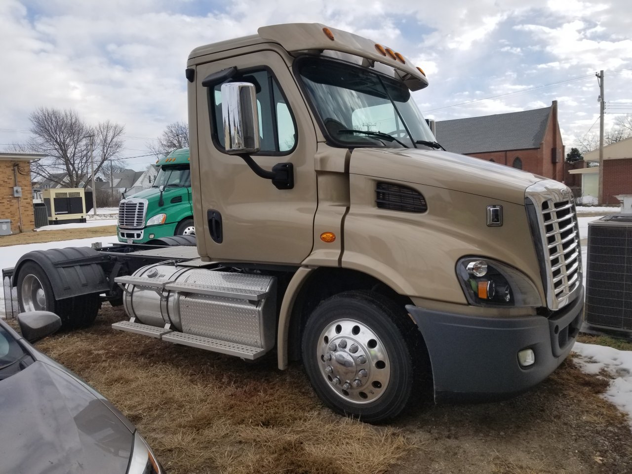

    I can understand you points on the Pu vs the semi, but you have to look at the big picture, If you are looking at this as a steady gig for years to come, first off, you don't buy a new semi, you buy a slightly used on, I picked up a S/A Cascadia last year that was loaded, leather int, heated and cooled seats, all aluminum wheels, a DD13 at 450 hp and 1650 TQ, coupled to a DT12 tranny.
    Out the door was 63,000 or about what you would pay for a "fairly" equipped new diesel pu, and the Cascadia had ,,,,,,33,000 miles on it, from past experience with my other Cascadias I change the oil at 25,000, could go to 50,000, brakes will last me around 600,000 miles, should go about 800,000 before it needs a clutch, drive tires will go around 250,000 steers about 160,000, If we were to run both trucks for 6 years at 130,000 per year, I would JUST be starting to get into heavy repairs, you would be on your 4th pickup truck!!!!
    None of this even scratches the surface on safety, resell value, braking ability, jakes, or the fact that you can put a real trailer behind it with air brakes and tires that will not have you worrying about when they will let go, I have done both, there is no comparison, AS LONG AS YOU SHOP WISELY!!!
