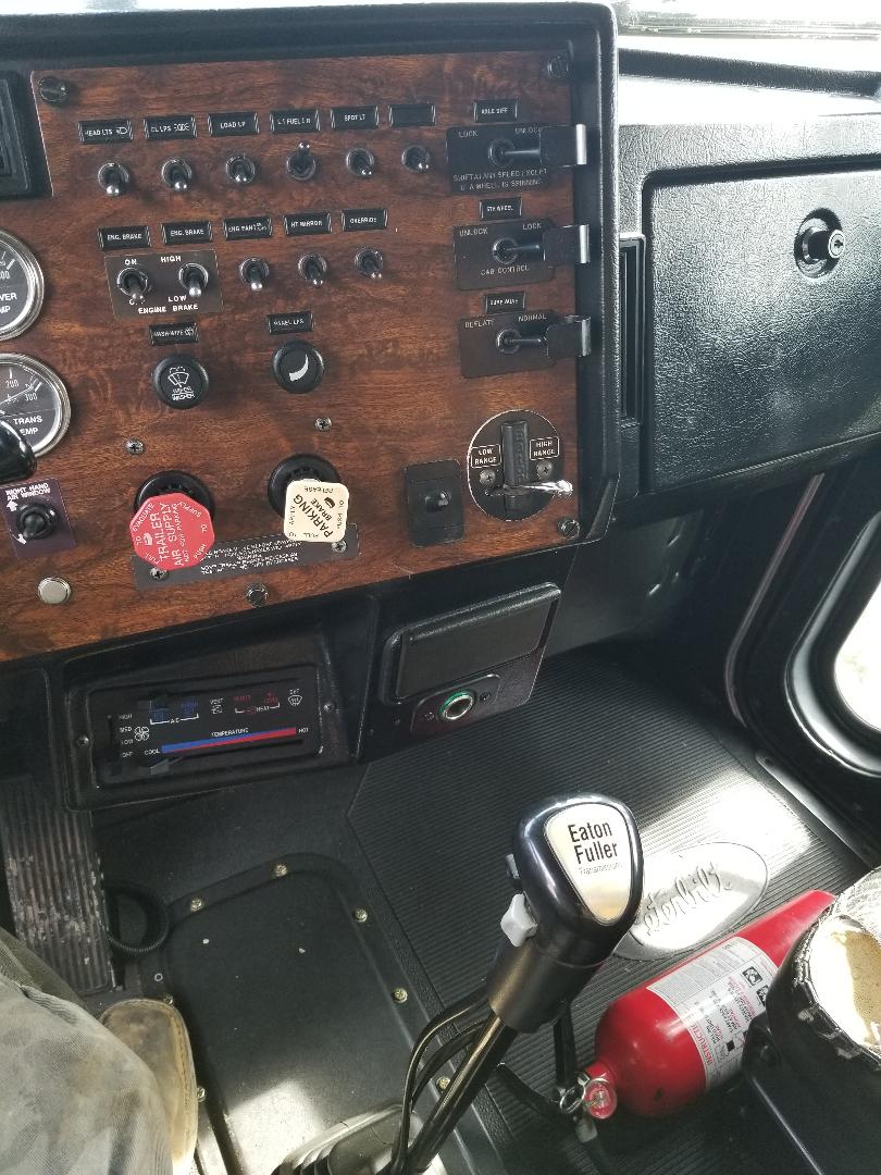

    I am sitting in a pete, i'd say around 2010 ish or so. It has the shifter of a super. Either 13 or 18. Haven't driven it yet. There is the traditional range selector, and then there is the gear splitter on the side of the shifter.
    And then, I look on the dash and see 'range selector' switch. On the dashboard. By the shifter. What? Why? Since when? pete.jpg pete1.jpg

    That ain’t no 2010. I’d say 90’s by lookin at the dash. Shift knob indicates an 18 speed.

    2 speed differential maybe

    Transmission is an 18 speed. 2 speed differential or a 2 speed aux transmission on the dash.

    How do you know that? I dont see anything "18" anywhere. Whats the secret?

    Splitter color.

    Looks like the switch on the dash is for a two speed rear end. Drove several trucks with them. Never used them.

    Duh me. 13 is red and 8 is blue correct? Never drove an 18 speed, just 8 and 13s.

    Those shift knobs all look the same to me. LL's and 15's can only shift the thumb button in low. 13's can only shift the thumb button in high. 18's can shift the thumb button in high and low.
    High and low on dash looks like 2 speed Eaton air shift axles for off road.

    wonder if it is a deep reduction set up?
