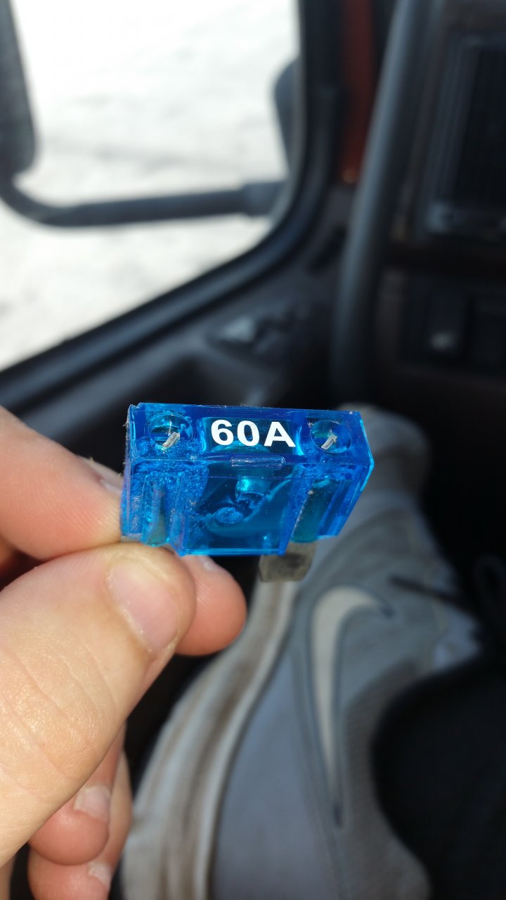

    Not many at all. Just enough to push a crock pot. I was able to run a steamer for my veggies and the crock pot at the same time. And now just the steamer will pop a fuse.
  6. Barbeque
    Barbeque Light Load Member
    199
    309
    Aug 25, 2015
    Everywhere USA
    Awesome, thanks. I bought this thing a year ago but just put it in a few weeks ago. Lol already popped 3 fuses.
  7. Barbeque
    199
    309
    Aug 25, 2015
    Everywhere USA
    Freshly blown.

    I know they are expensive (about $2000), but if you are requiring 3000 watts for an inverter, then I would steer you the way of a pure sine inverter/charger like what Hurst is referring to. You can plug into shore power and get a 150 amp charge. It automatically switches to the shore power or inverter modes. You can also use it with your generator/apu for consistent, reliable power. Some electronics are sensitive to the modified sine wave inverters and you will damage them with long term use, if you can even get them to work at all.
    These are reliable and well worth the increased prices. In another month, you'll have paid the difference in all those expensive fuses you keep blowing!!!

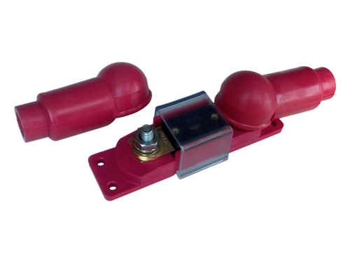

    I use this style of fuse and holder. Only larger amperage.

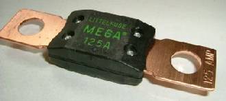

    I'm using a relay (Breaker style) that looks similar to your bottom pic. Coming directly off my batteries. 250amp. I've never had it trip. But supposed to trip when it gets hot. Then reset itself once cooled down.
