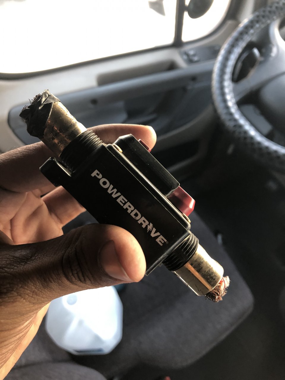

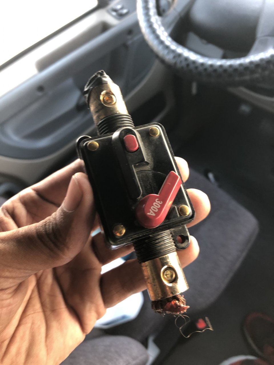

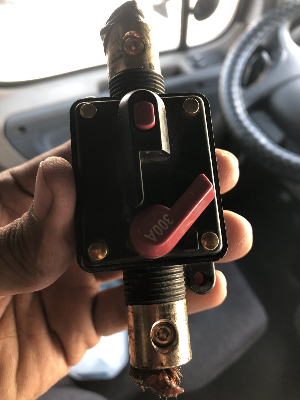

  10. The Highway Hustler
    The Highway Hustler Bobtail Member
    40
    24
    Jun 25, 2019
    The old inline fuse with breaker switch C63E47CA-0DB3-4849-9B20-3DC40CDF43C6.jpeg F0CC1CE8-2082-4F78-BAD4-5ECF97BA918E.jpeg F0CC1CE8-2082-4F78-BAD4-5ECF97BA918E.jpeg 99F518A0-90F6-409C-885C-AAFF4CB96F12.jpeg
