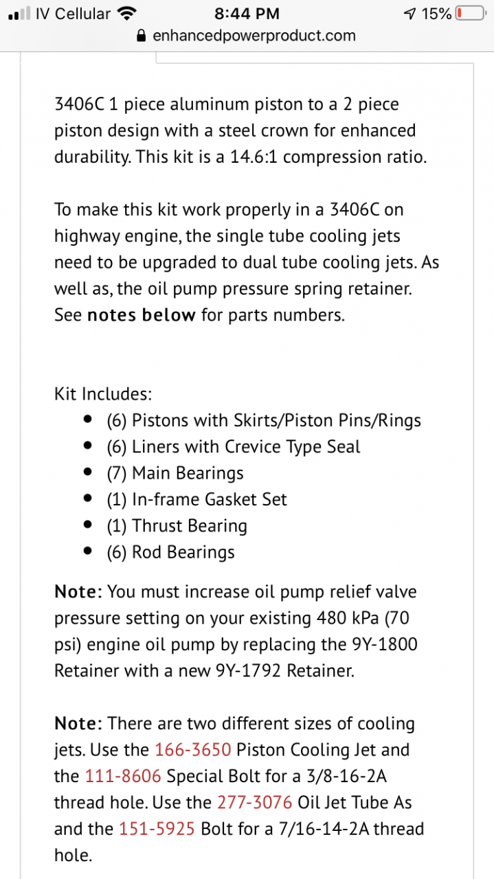

    73D02CB1-6D9E-4383-9F78-26F08D0FC7C5.png I seen IPD makes a two piece piston kit with correct oil jets if you don’t want to go the cat route and have the rods wore out has. In all the years of info on this site and the garage I never really figured out the exact c model nozzle that matches the steel top piston with no additional timing modifications

    I have not had a 2 piece piston in my hands yet but have seen pictures.
    I’ve only got to see a B model piston and a steel C15 ACERT piston so far.
    Are they actually more durable?
    I think that’s what’s in the E model I’m currently driving. 37,000 hours on it, over 1 million miles, still going well.

    @Gambino1994 i saw that kit listed as well. I would be curious about the correct nozzle to match those pistons too if anyone has that info.

    Every motor I have seen with that steel top piston has issues and is short lived. Now I haven't assembled one myself but.....

    I had figured the 2 piece would maybe vibrate a little as the steel crown is on a hinged pin that is held center by the close tolerance to the sleeve and aluminum skirt.
    Also both metals would expand and contract at different rates.
    So I’m guessing by keeping the power levels down, like factory 475 hp, maybe helps make the 2 piece piston live longer.
