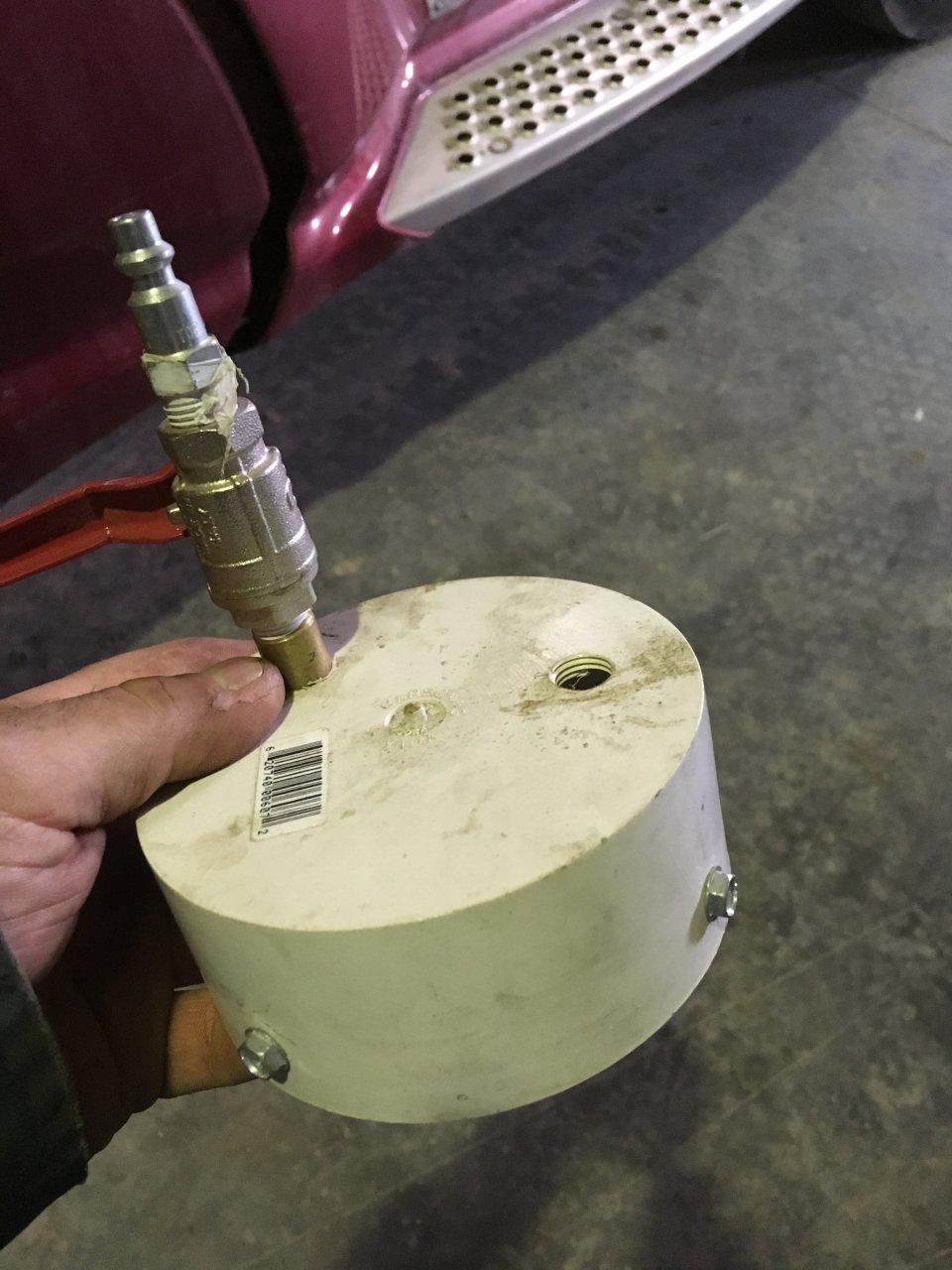

    Need to make up a rig to check for boost leaks.

    Couldn’t find any leaks. Does a boost leak drive up coolant temps too? Don’t forget she’ll make 26 psi and seems to have plenty of power

    Sigh. Went to get my boost test rig and there’s a hole where my psi gauge used to be. #### shop monkeys
