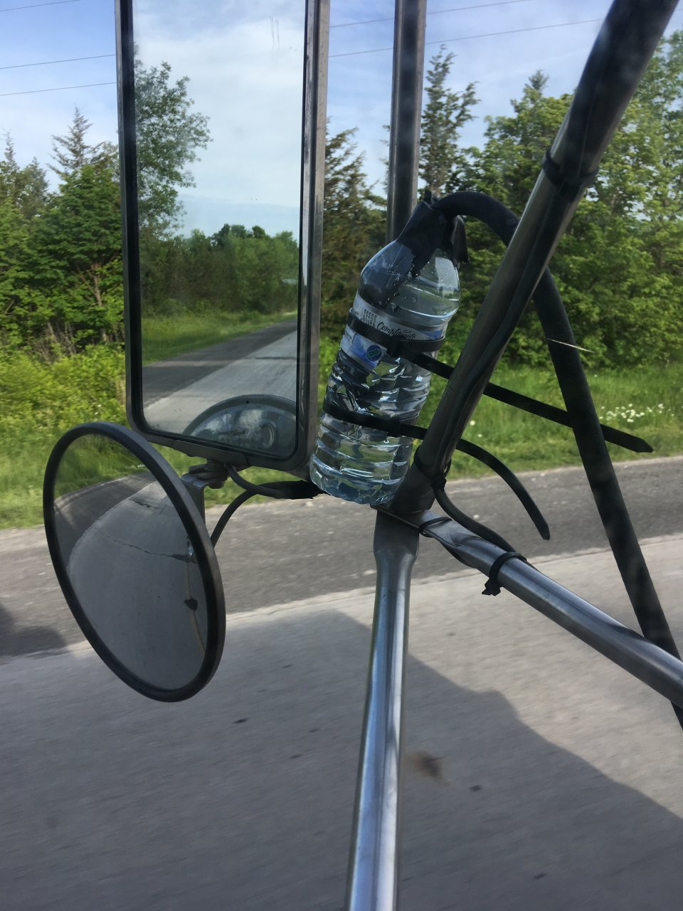

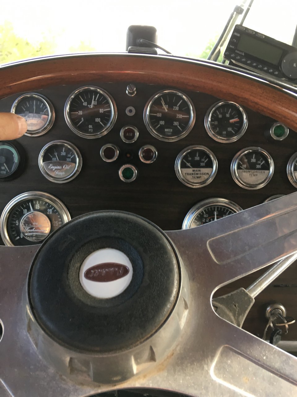

  9. rank
    rank Road Train Member
    9,919
    113,510
    Feb 11, 2010
    7C5789E7-84EA-49E4-A86A-F51083C03068.jpeg E25904FF-C91C-42EB-9A38-9702D80A7DBF.jpeg
    First ride today since I asked the question. No bubbles and no high temps but not much of a test since I was empty on flat ground and only 68F today. 7C5789E7-84EA-49E4-A86A-F51083C03068.jpeg

  10. AModelCat
    29,758
    165,336
    I love that I'm not the only one who ghetto rigs up stuff :D
    I once drove around with multimeter in the cab with super long homemade leads clipped to the battery so I could chase an overcharge issue that only ever occured while driving :cool:
