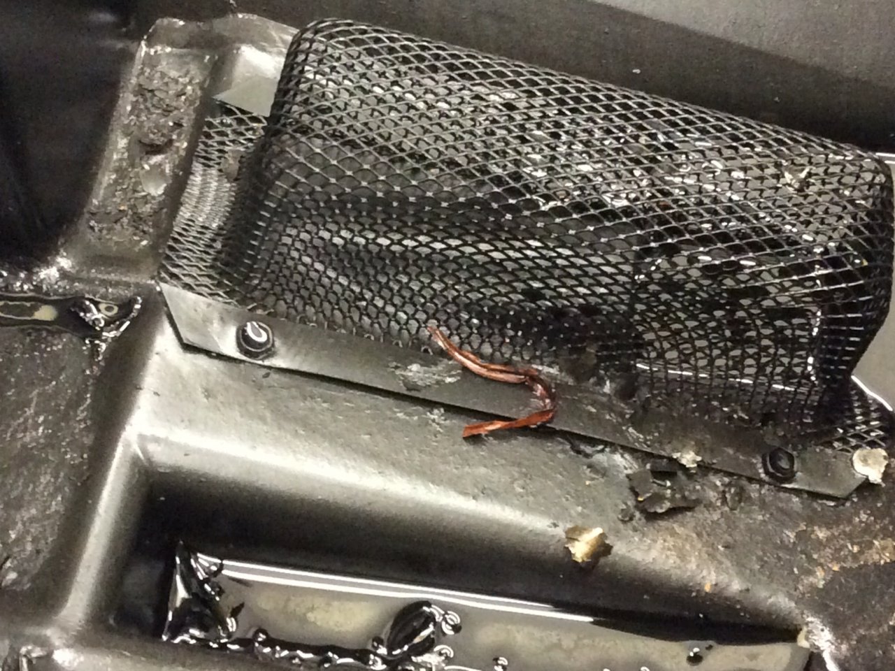

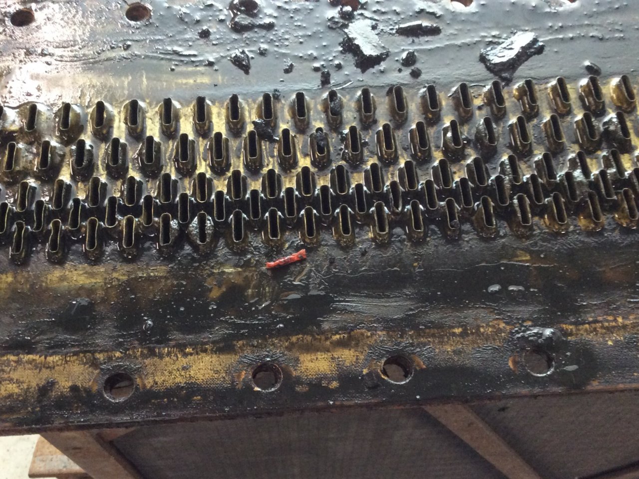

  10. OLDSKOOLERnWV
    19,310
    291,916
    This is clean in the picture. When I bought the truck I'm driving it had a seized engine, seized on the crank. Radiator, oil pan, all was full of red silicone chunks, every piece bolted on the engine has mass amounts of red silicone hanging on it!! Checking your radiator could be a good thing?
