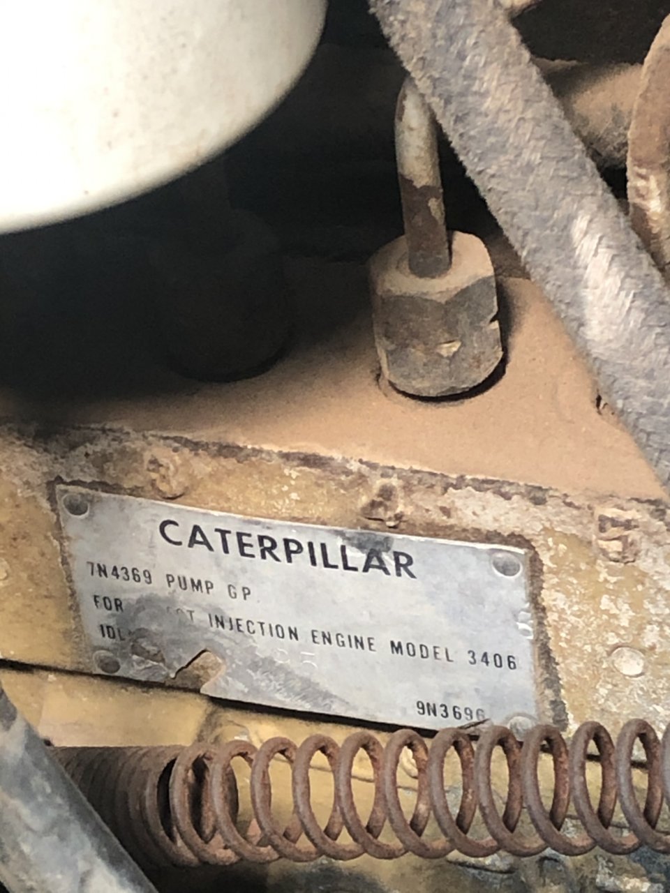

    When I first looked at the truck and pulled back the hood I say on the injection pump it said “for engine model 3406” on the plate. It’s a 7n4369 pump that sets midway on the engine.
  8. Onewolf81
    Onewolf81 Bobtail Member
    40
    33
    Jan 4, 2020
    D4CC5FF8-7E42-4597-9C49-736A767DDAD6.jpeg When I first looked at the truck and pulled back the hood I say on the injection pump it said “for engine model 3406” on the plate.
  9. AModelCat
    29,853
    166,439
    Looks like it says "For Direct Injection Engine Model 3406"
    Mine says "For Prechamber Engine Model 3406"
    Yours might have already been converted. Look at the front and rear of the head for the glow plug wiring. Just a single wire feeding the stud for the front 3 and a single wire feeding the rear 3.
    Oxbow, Onewolf81 and Bean Jr. Thank this.
  10. AModelCat
    29,853
    166,439
    The glow plug pass through studs will be threaded into the front and rear of the head. If memory serves me correctly they're about an inch below where the valve cover sits. Another easy way to tell would be to simply pop off the easiest valve cover and post a picture of the injectors. We could definitely confirm if its direct injected or prechambered then.
