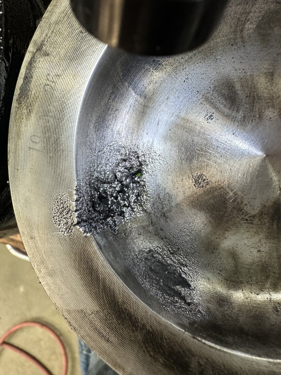

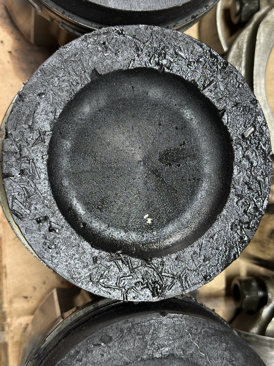

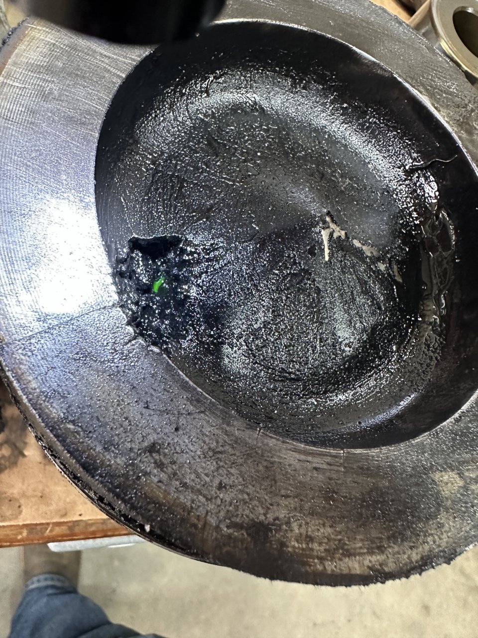

    If it wasn’t rattling till it built boost i don’t think the timing caused that damage. Have you got any pics of the piston tops

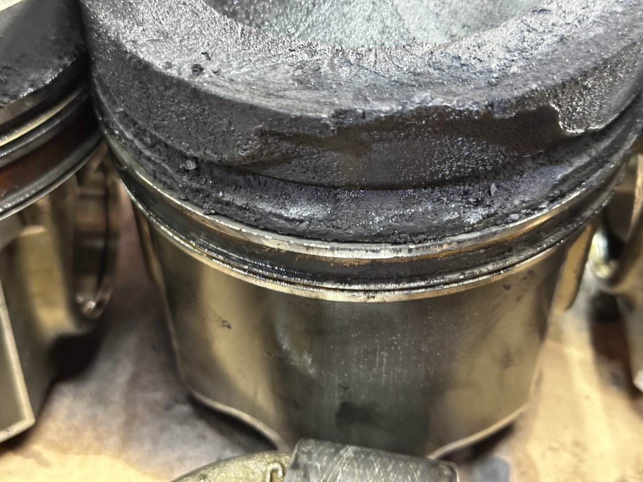

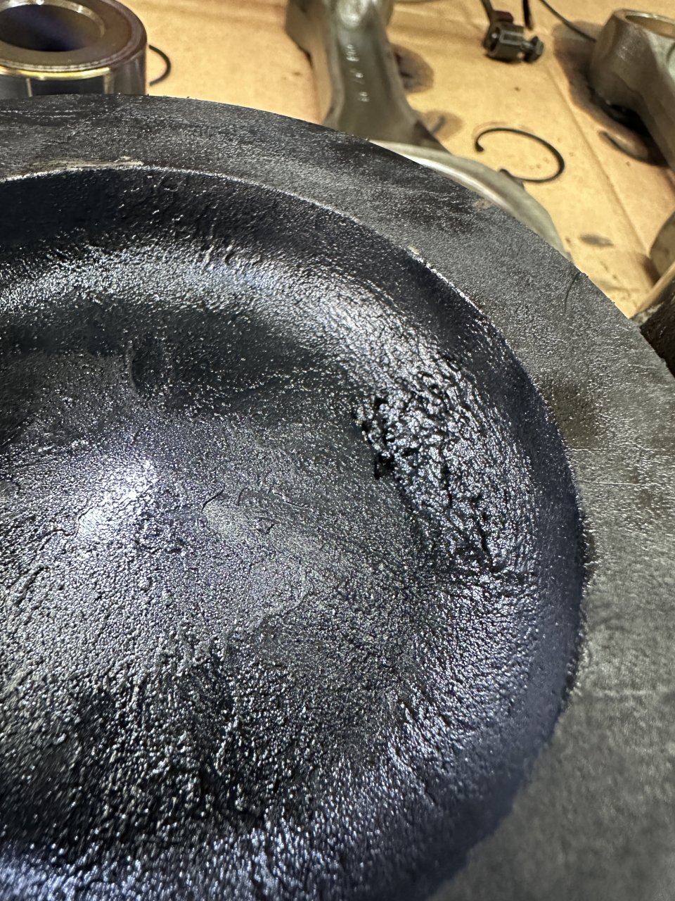

    I’m am no photographer but here’s a few pics of the pistons. I know pictures don’t really show it good but 2 of the pistons had holes almost all the way through. Also, I was wrong in what I said about the position of the holes. The pistons with holes were 1,2&5. 1&2 had holes toward the rear of the motor and 5 was toward the front.
    I checked the pinned timing and it is spot on. Pulled the outer and inner cone off the advance and everything looks to be in like new shape. Now whether or not it’s adjusted right, I’m not sure.

    I'll be interested to hear what @wore out has to say about those photos, but in my mind you need a new set of nozzles when you go back. The oil and erosion around the pistons is interesting. I can't imagine it ran well.

    @Oxbow the plan is to go back with the pistons and nozzles for the 4ck 460 peec like @wore out recommended. Called cat today to get an eta on the nozzles and make sure they will take these 3421’s as a core. I will go back with an ipd in frame kit but they do offer those pistons. Will probably run it and see how it does with the turbo that’s on it since it isn’t 2 months old and just watch the pyro close to see how it does and go from there. What’s you guys thoughts on head gaskets? Some say to only go with cat but again you can read anything you want to search for nowadays. Hard to find people with the experience to back it up.
