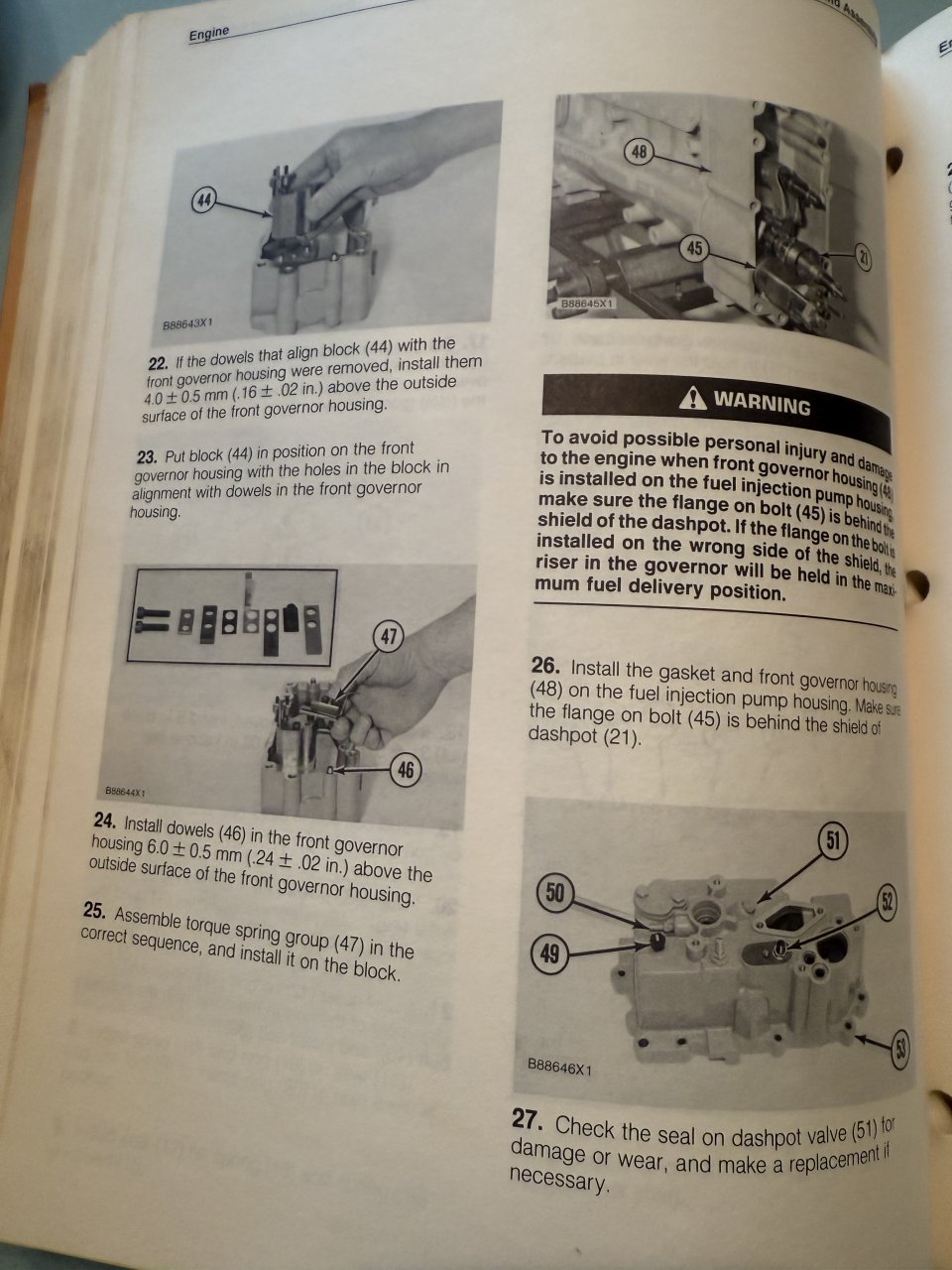

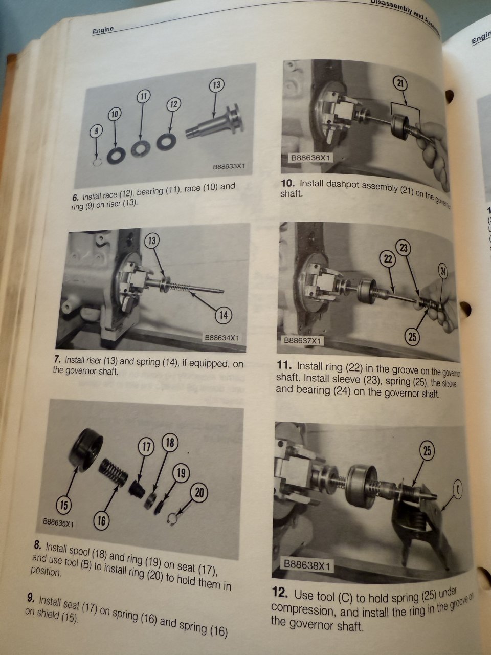

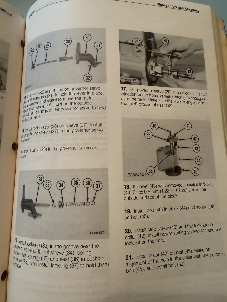

    IMG_0573.jpeg IMG_0574.jpeg IMG_0575.jpeg IMG_0576.jpeg IMG_0577.jpeg IMG_0579.jpeg IMG_0580.jpeg IMG_0581.jpeg IMG_0582.jpeg
    After discussing things with @Oldiron94 I feel his best solution is taking the govnor section off his 7FB pump and putting it on his 3ZJ pump. That will get his timing back in order hopefully preventing cracked piston tops etc. I decided to put this out in the open forum as it may help someone else later on as these pics are directly from the service manual on how to do that. I would also like to thank @OLDSKOOLERnWV for getting them this morning.
