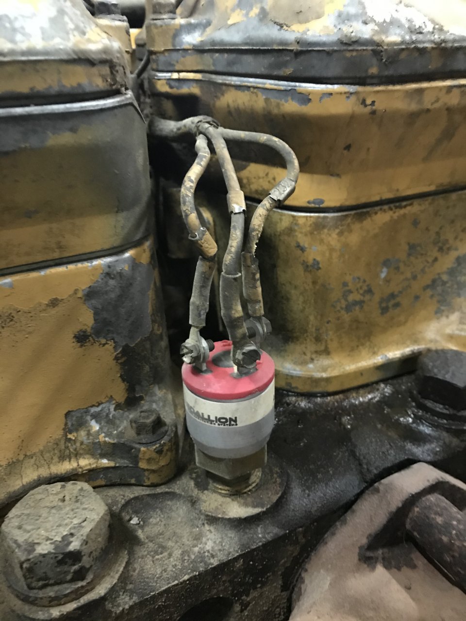

    My two B models have three senders. I believe the two in front are temp gauge (single pole) fan (double pole), and the one in the middle right side goes to the high temp warning light (single pole) or, if it had a Kysor shut down double pole.
    I have had Pete give me the wrong sender according to VIN as you say.
    mile marker 27, Goodysnap and wore out Thank this.

  11. mile marker 27
    mile marker 27 Road Train Member
    1,419
    1,739
    Dec 4, 2019
    Yes sir, I’ve got another sending unit beside the coolant unit. It’s right beside and you the left of the coolant one. 2 wires, if I recall? There’s another in the middle right side of the head, tween the jakes. I got a pic of it.
