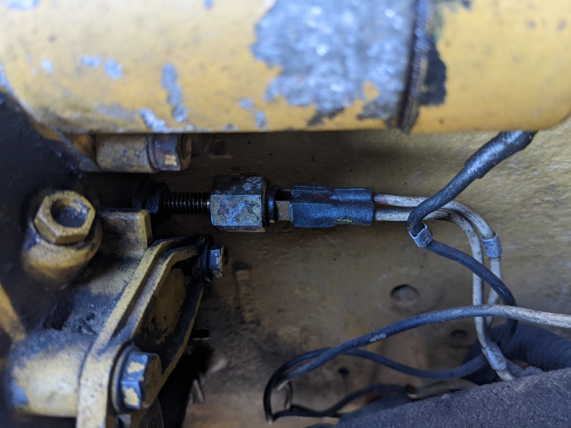

  7. mile marker 27
    mile marker 27 Road Train Member
    1,419
    1,739
    Dec 4, 2019
    750385F2-E761-4B50-A575-DDA73D91FC25.jpeg I found a pic that’s like the one on the blown up engine.
    Oxbow Thanks this.
  8. Oxbow
    Oxbow Road Train Member
    13,684
    141,939
    Nov 24, 2015
    Yep, that's it. You have a mechanical tach drive on that one too.

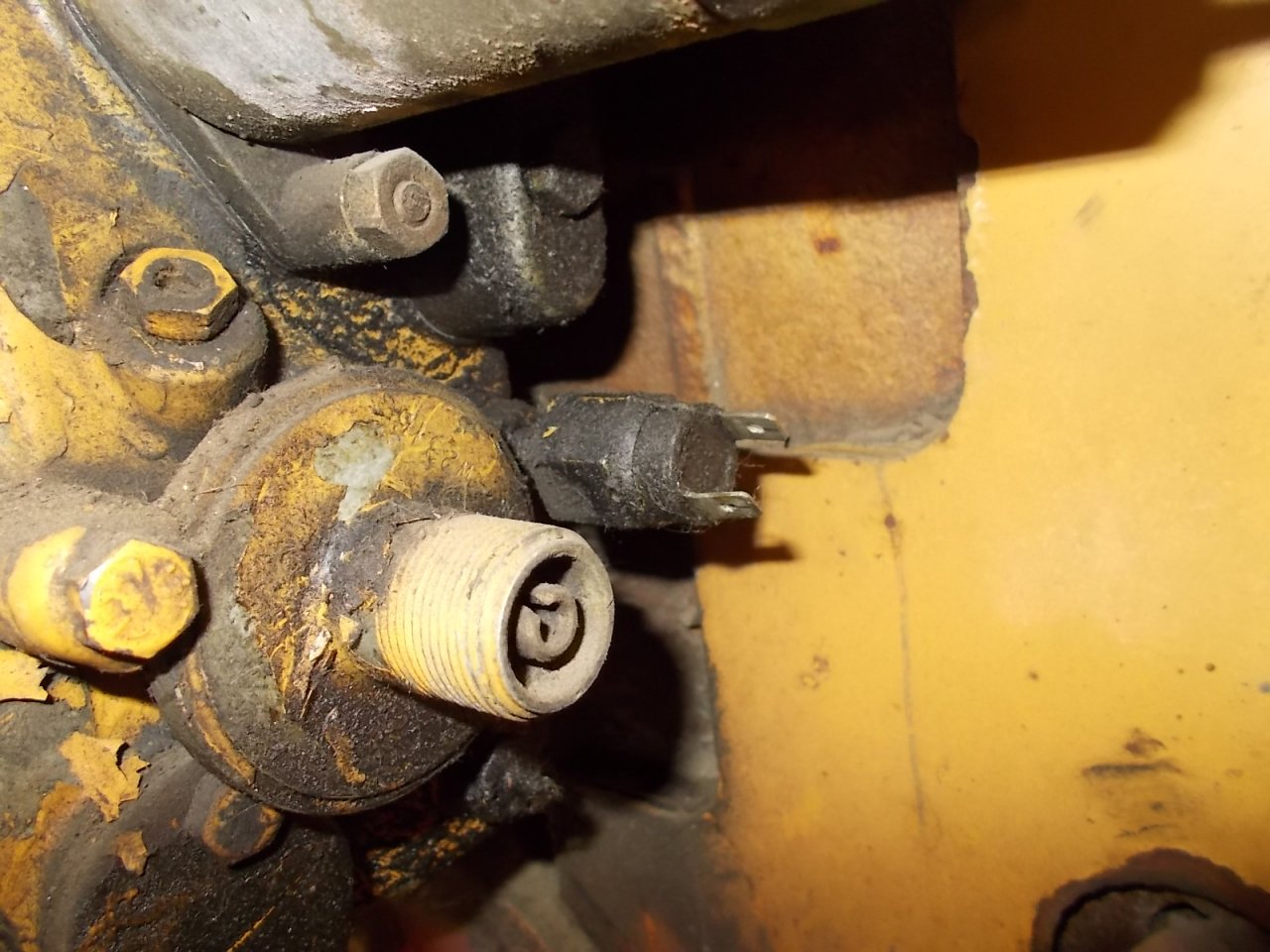

  11. mile marker 27
    1,419
    1,739
    Dec 4, 2019
    5A15AA0B-9DF2-4F0D-928A-BD9B60759E5D.jpeg Here’s a pic of the one that on the 4MG.
    wore out and Oxbow Thank this.
