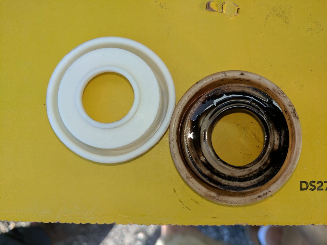

Old and new ADR diaphragms. You can see the inside diameter of the old one is larger than the new one.

Sounds like an Afrc to me.

Yes air fuel ratio control valve. They are bad about getting pin holes. If you pulled the cap and found oil in it. It's probably leaking.

They restrict rack travel until the open up. If they won't stay open, you're unable to get full rack travel which causes low power

I bet that's it. There was substantial amount of oil. Temps are all fine driver has been running just fine. I have it scheduled to go in soon. I'll update
