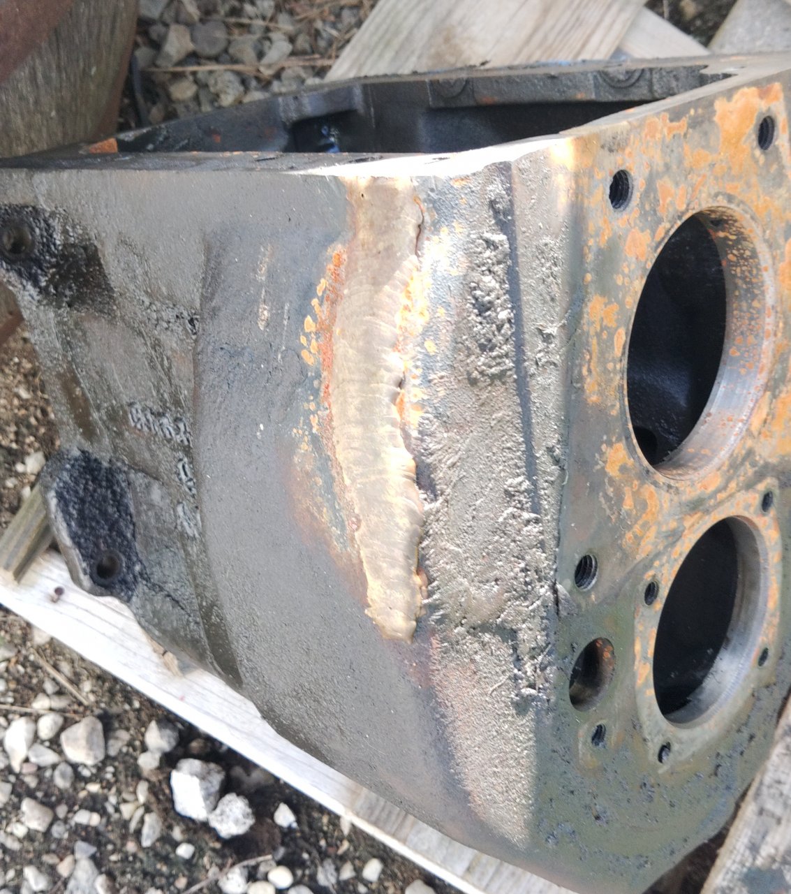

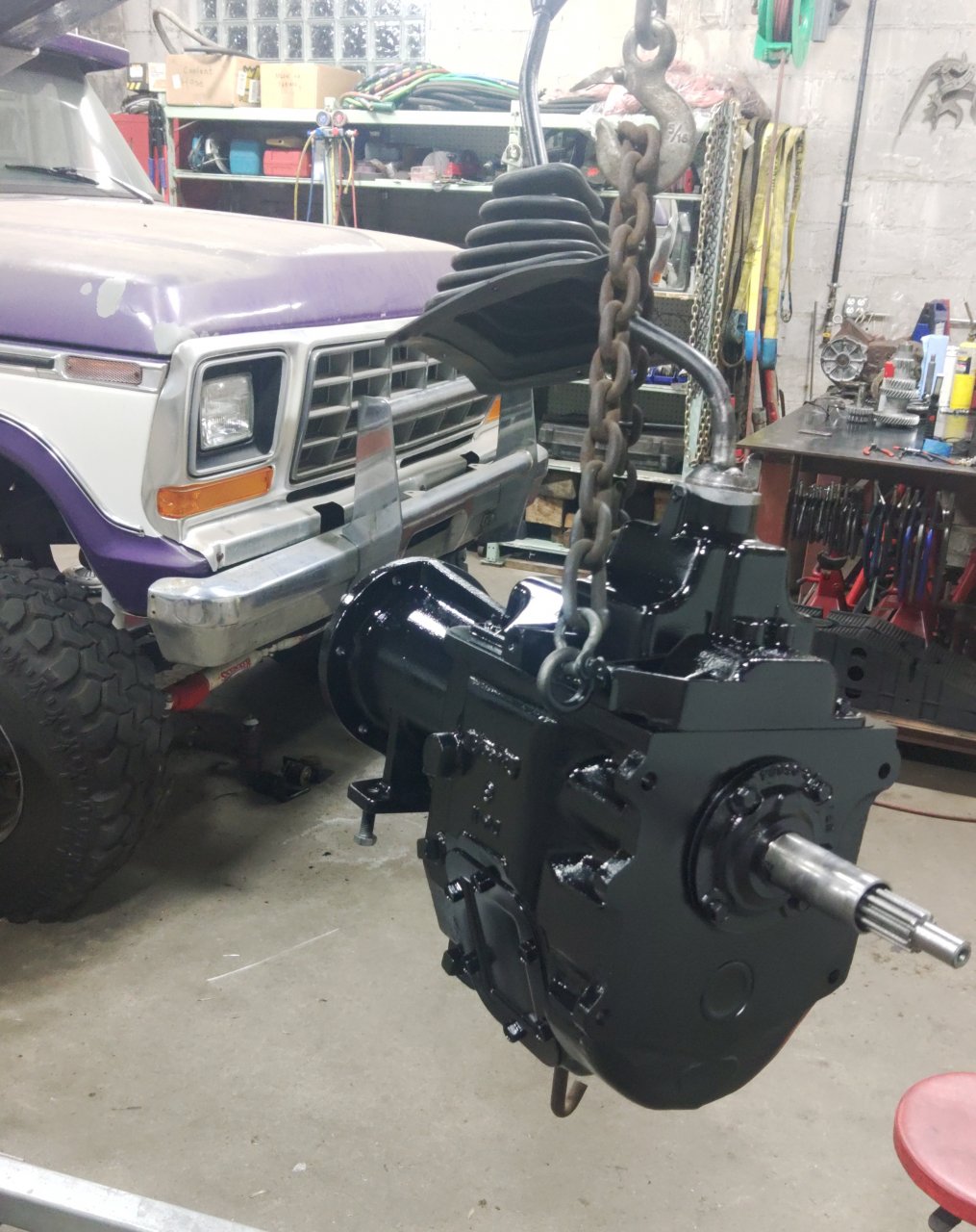

    Let's get this thread rolling. In all reality, I am 39 years old so the "B" is before my time but I am lucky enough to own one. My 82 A model glider was repowered at one time from a 92U "A" 3406 to a very early production 7FB. I am lucky enough is was a factory 400HP/1375 ft/lb JWAC engine. From my Cat diggings, the first 7FB's for production were built on January 3, 1984 in Mossville, Illinois. The production run went til approximately September of 1987 and had a 425 HP ATAAC version with 1450 ft/lb torque. Now I could dig more into this if folks are interested, but I don't have much free time with job, family, side repairs, and garage projects. Current project is wife's Ford. I am bad about going down rabbit holes. I am putting MSD atomic EFI on her toy, but needed to replace ring gear on flywheel. Turned into rebuilding transfer case, rebuilding transmission (case was cracked and "repaired" once). Some pics KIMG0234.JPG KIMG0265.JPG KIMG0245.JPG
