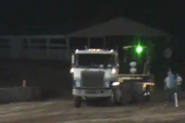

    Not the one I use, I doubt very much it would last a week or two on a working truck. If I were building a road truck I would be using a FASS to supply fuel and by pass the transfer pump.
    Old video, but it's one of the better ones.
    http://i293.photobucket.com/albums/mm65/Truckinbobb/Germantown Ky 2010/M2U00370.mp4
