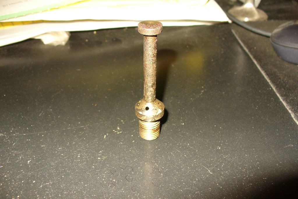

    what does the AFRC cost new? is there a way just to unscrew nailhead from the AFRC body? it looks to be like 2 parts?

    well i decided to a lil test myself i was able to seperate the nailhead part from the rest of the AFRC..... yup i didnt cut it off i just took it off, now behind this nailhead piece seems to screw into a passage way for oil to come thru, with 4 little holes all around the base of the nailhead piece. at first i was just going to plug it with a bolt but then when i noticed oil flowed thru it, i simply left it open so that the oil will spew out maybe not out of the intended small holes from the nailhead piece but it will still come out of valve with out topping off pressure.
    the reason why i did it this way was to not damage or modify original AFRC just in case i wanted to go back to the way she was running before i can just rethread nailhead piece back into AFRC and turn in my torque and fuel screw settings just in case, with cutting off the head i wouldnt have been able to do so only by re welding the part that was cutoff to the AFRC piece.
    i am going to do a road test now to see the difference she blows smoke but only when you rev it up somewhat higher then 1k rpms anything under that she burns clean, and if you double tap the pedal she will billow out a nice bush of smoke. now its time to see how she smokes on the road under load or pulling conditions lets see.
    this sure is fun after getting into it.
