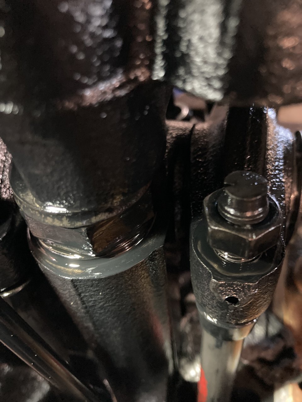

    I am resealing a good running b model with 650k miles (to the best of my knowledge). As I have taken things apart I don’t believe it’s ever been into at all.
    Couple things I have noticed that I don’t like
    When I turned the engine over to work on replacing bearings diesel fuel ran out of the injector retainers…I wouldn’t think this is normal. I have seen it run for roughly an hour…it’s out of a wrecked truck. In this time it didn’t seem to have an oil dilution problem. I don’t know about before because the oil pan was broken enough to let it leak out. No evidence of fuel dilution on the bearings or anything else so far.
    I assume there’s some type of improved screw for the rocker arms that actuate the Jakes…maybe someone knows the pn?

    You’re gonna #### when I tell you price of just that screw is a hundred and some bucks at CAT in Springfield. But you are definitely flirting with disaster right there.
    P12810 is the PAC brake number. You’ll have better luck googling jacobs or pac brake for your part numbers on the jake stuff. It’s noticeably cheaper to at like TAG or MHC as well

    The correct screws use a rounded head on the exhaust valve with a 1/2 head. The original were never meant to be used with a Jake. Not a real big deal other than tells me the Jake was added to that motor after it left the factory.

    Don’t know if you saw my other question about some diesel fuel in the injector retainers that ran out when I turned it upside down to work on the bottom end.
    Any thoughts as to why there’s fuel where it seems there should be oil?

    Anytime you have diesel in those retainers it’s nozzle time in my experience. You can look at the bleed screw and seal but usually they are leaking where the top part screws in to the nozzle.
    I use a pass through connector with a fine threaded nut, a head bolt and a wrist pin for a nozzle puller. The small end of pass through threads right into nozzle. A long barrel nut onto big end the head bolt and wrist pin. If you don’t have one rigged up already
