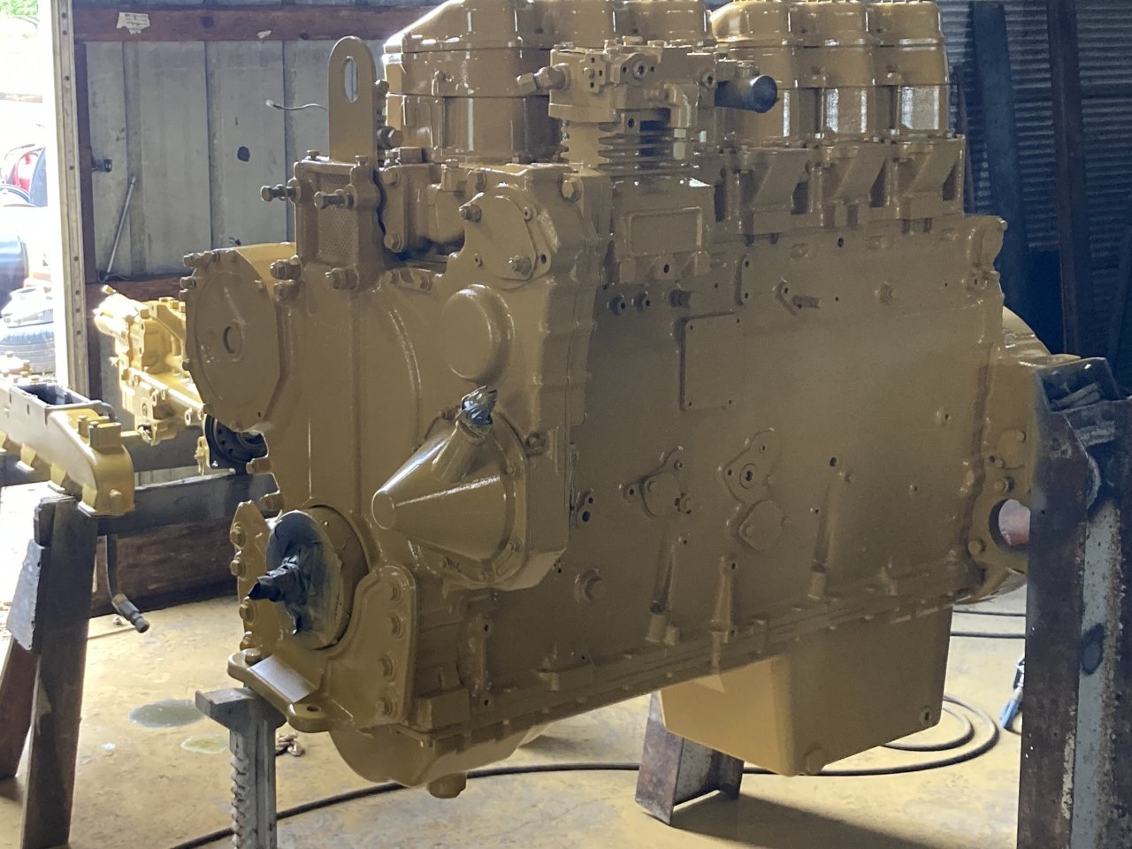

    its just about done…DuPont overhaul is complete lol
    LameMule, Sons Hero, wore out and 2 others Thank this.

    Looks great but be careful with that jack stand deal. Heard of a big Cummins slipping of a stand and nailing a mans hand to the floor.
    W923 Thanks this.

    Yeah it’s not my favorite setup especially on that angled ford mount. You can’t really see it in that picture but there’s a bolt though the mount to prevent that

    A retired boat mechanic rebuilt my 350 boat motor in my shop. He had it up on stands like that with no bolts. Next thing we know it was fired up. Then he was gassing it and shut it off. We were all in holy crap mode. He said if there is a problem I want to know it before I put it in that hole. He was about 76 years old and the motor is still doing fine 5 years later.
    True story but the point was to be careful. Things do not always work out so well
