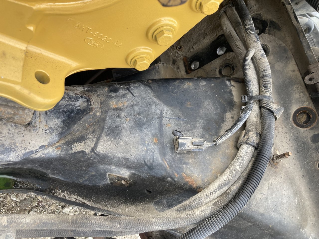

    I would say it’s to make more room for the drivers feet. The engine has about the back 6 inches in the cab and there’s a noticeable amount more floor on the driver’s side of the doghouse than the passenger side

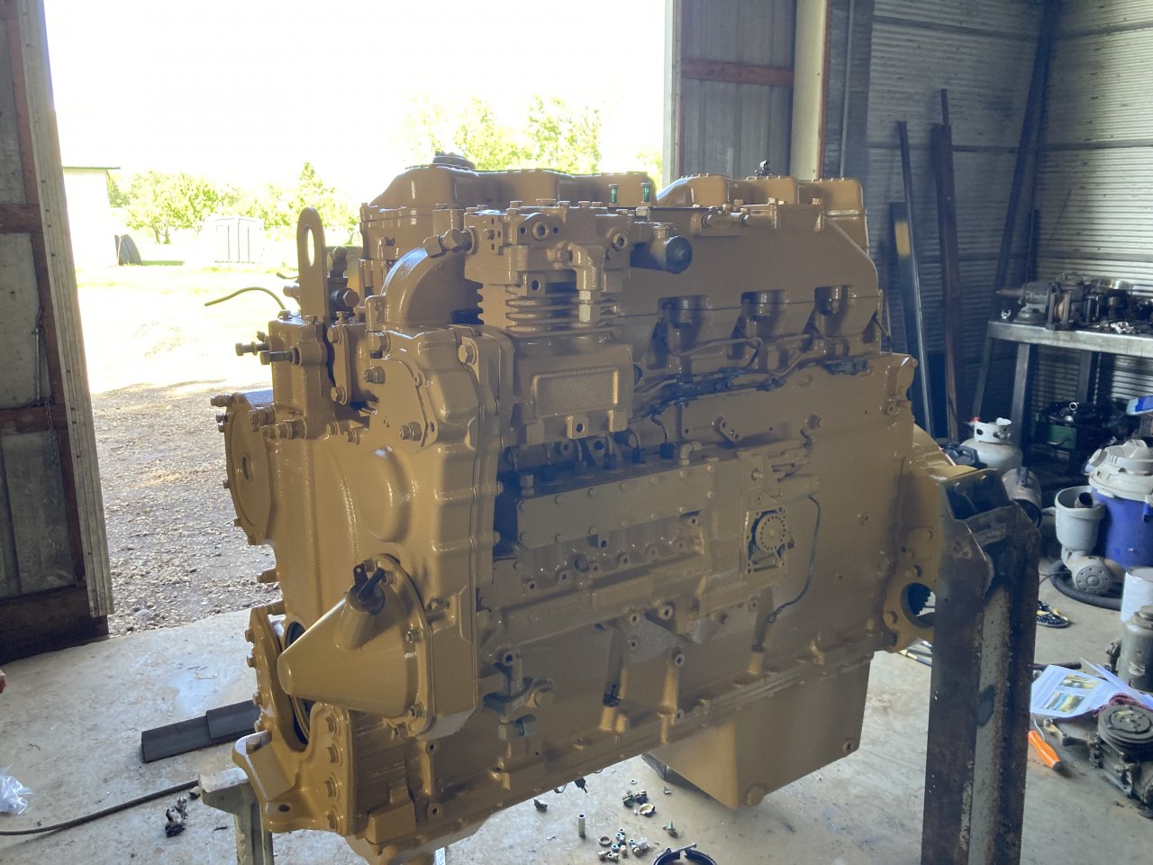

    Yes I had 2 engines but really only used the one to get the parts needed for a ford application (flywheel housing, mounts, exhaust manifold and a few other unimportant little trinkets). The other engine was a good runner and just resealed and put bearings and injectors in it. I am using the pump timing advance and turbo that it was running on when I got it.
