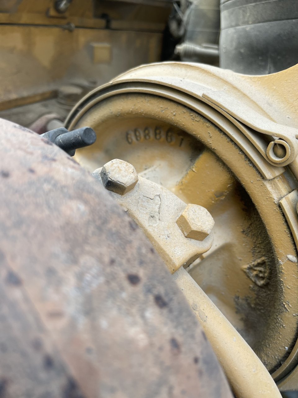

    Friend of mine in Norwood Mo, has an ‘80 model “A” with this in it. IMG_2346.jpeg

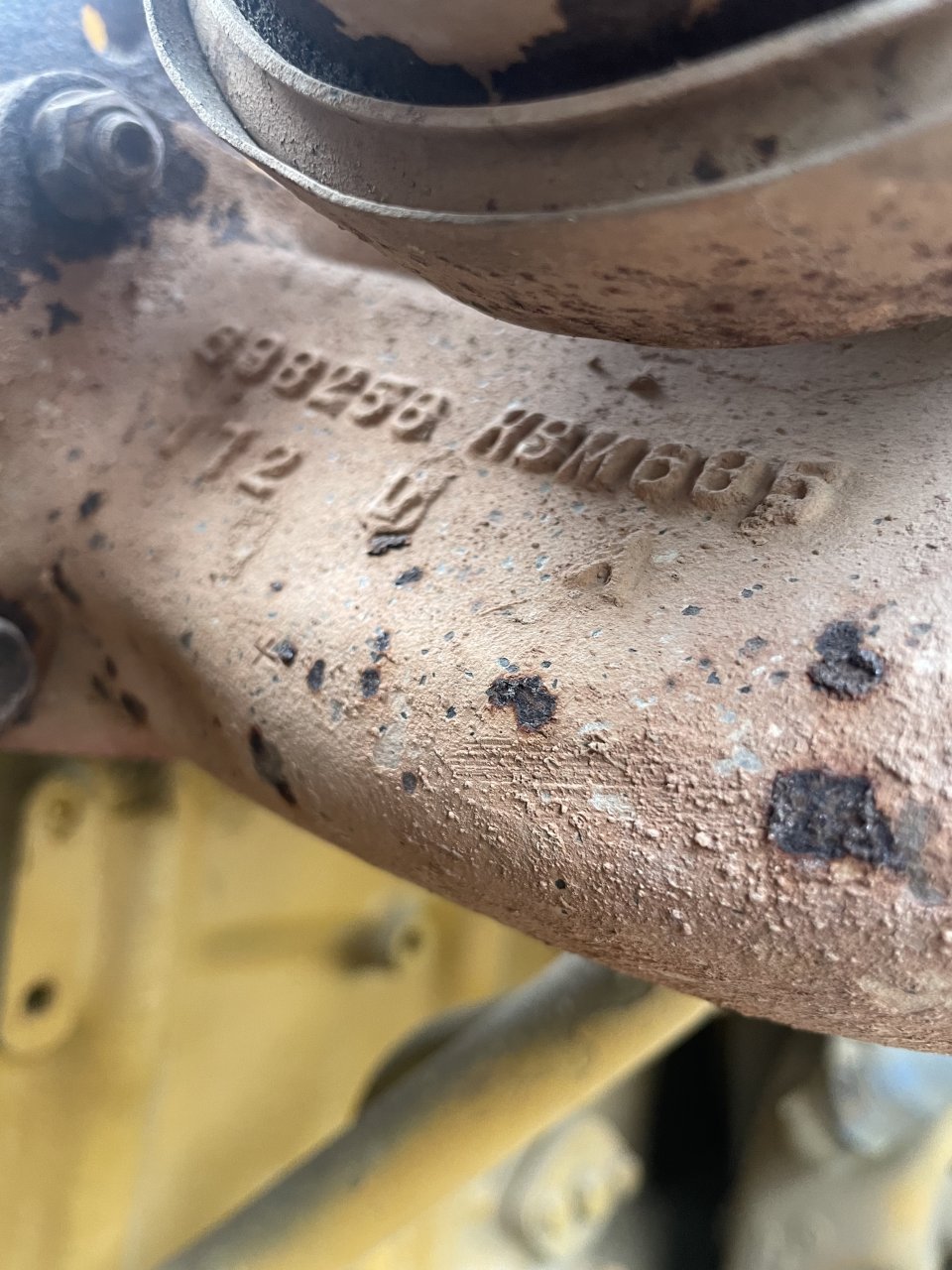

    Here’s some numbers on my existing turbo. Not sure if you can make anything out of it but there’s no tag on it. IMO, this turbo has quite abit of lag particularly once I get up on 13, 14 and 15th gears. That said it’s a dump truck, with a 15 OD and 3:55 rears. Probably the only dump truck in these parts with this combination.
