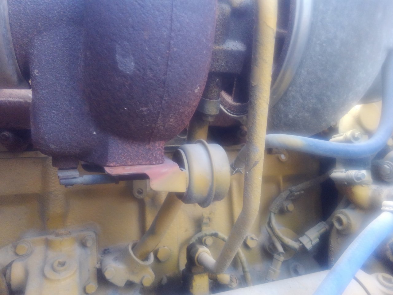

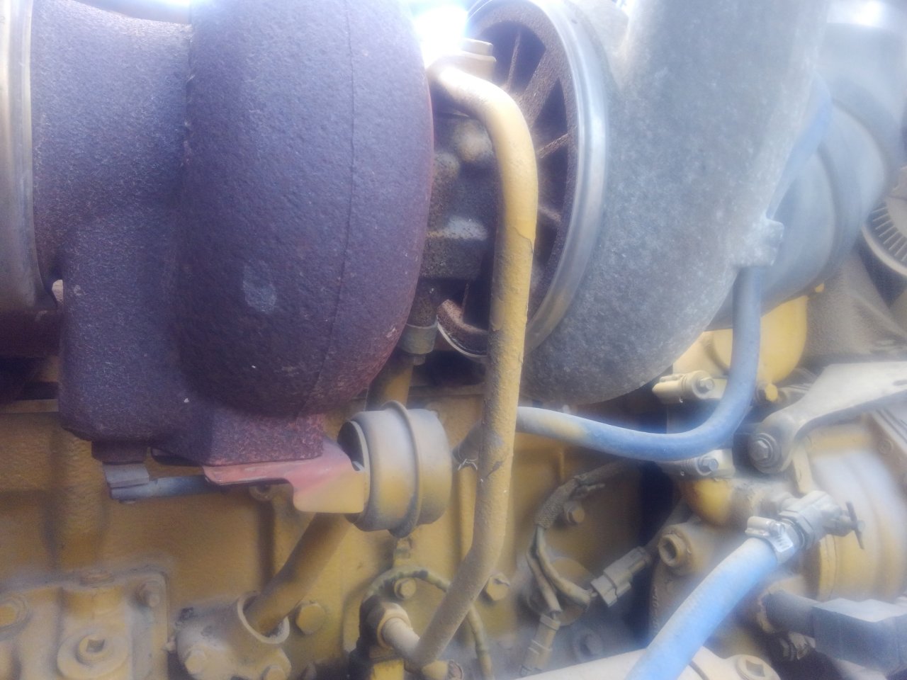

    Only other two supply hoses for non brakesaver engine is 159-9584 and 280-8170. Drains are 133-8940 and 116-2680. You have a 90 or 45 degree supply fitting? Take a pic and post it.

    These pics should show the fittings on the engine.

    Here is the last suppy tube I purchased 199-3211, comes up a bit short. IMG_20180828_124441785_HDR.jpg

    Some E turbo oil feed comes from backside. Also, looks like you can clock your center section more towards block.

    I will try to clock it a bit, not sure it will make up that much...thank you.
