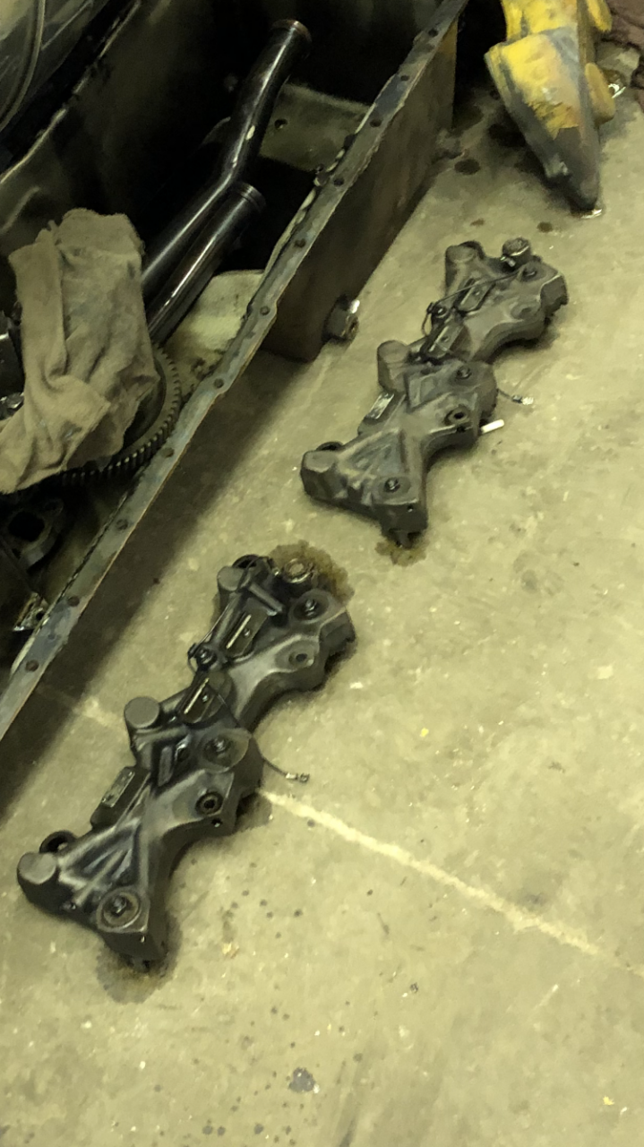

    E2F0AF4B-BBFC-46DD-BACC-CCB3AAF4F400.png ok, these r the brakes, would anuone know by lookin at these what they r?
  5. Goodysnap
    Goodysnap Road Train Member
    3,782
    9,223
    Jul 12, 2017
    Need a closeup of the metal ID tag

  7. kranky1
    kranky1 Road Train Member
    2,253
    8,855
    Sep 16, 2015
    Ontario, Canada
    The model# is on the metal tag on the housing.

  8. LameMule
    LameMule Road Train Member
    1,148
    7,418
    Jan 19, 2020
    Montana
    Look like pacbrakes but I'm no professional
  9. LameMule
    1,148
    7,418
    Jan 19, 2020
    Montana
    Scratch that, I just looked at an old picture of my pacbrakes and they're quite different than the picture you shared.
