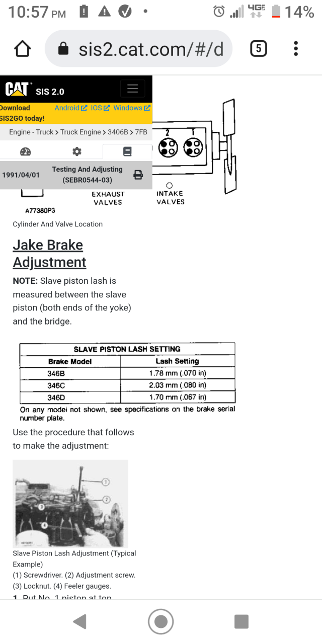

  7. Big Road Skateboard
    7,241
    41,239
    May 2, 2021
    Those are Jake's. I thought all B's set @ 30. Maybe @wore out can confirm
    tj379 Thanks this.
  8. tj379
    tj379 Light Load Member
    237
    226
    Nov 10, 2019
    ontario
    correct, just looking for a model so i can get the correct spec , ill pull a cover to check id tag when i get a cance

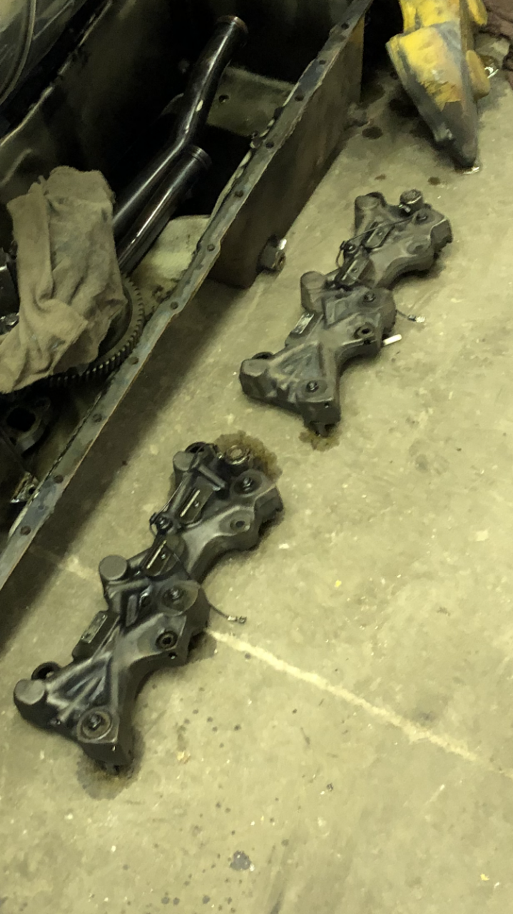

  10. tj379
    237
    226
    Nov 10, 2019
    ontario
    Big Road Skateboard and Oxbow Thank this.
  11. tj379
    237
    226
    Nov 10, 2019
    ontario
    looks like none are set to .030
