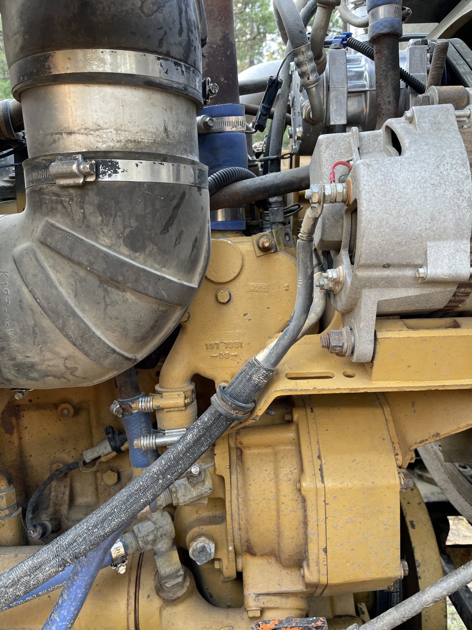

    If it was me I would find my issue. I would plum a pressure gauge into an existing outlet from water pump and check pressure should be 14lbs or so. If that’s ok I would go to radiator and check temp differential between top and bottom hose if it’s much over 15 degrees you have a flow problem. Is the vent line from thermostat housing to top tank clear and flowing with engine running? Is the front of the oil cooler clean of all debris cause that’s where they collect. The odds of the radiator itself not being big enough are good. It takes way more radiator for a 14.6L 550 than an N14 at 340. Is there a shop towel in the system??
    The fan may very well be a part of it, however is it all of it? I would try to find out if the same C500 came with the same radiator for both engines. I also can’t tell you how many times in life I have seen an old tired motor rebuilt only to run hot after. The radiator being the cause, because the motor was tired it had enough flow to keep it in check even though its flow was way down. Once the motor was back close to 100 percent it can no longer keep up. And as stated I can’t tell you how many times I have asked people if it’s clean in the front to be assured it is. The first thing I see is grass hanging out between the radiator and air to air

    Which line is coming from the thermostat housing? Is it the top right next to the main upper hose?
    I did just see a video of the guy rebuilding one and finding a rag in the oil cooler.
    wore out Thanks this.
