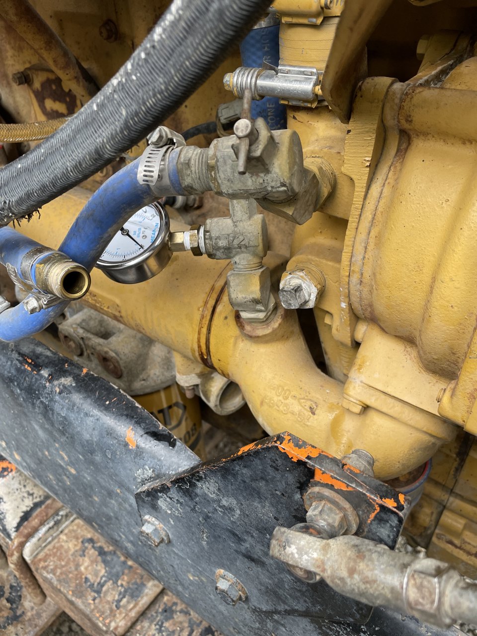

    Using this spot as it was an easy no leak (two shutoffs on the heater line) I only got about 1-3psi at idle and 12psi at around 1200rpm. Is this an okay spot to check?

    Yes that is the direct outlet of the water pump.
    That pressure is low, but there is a confusing issue here. That should also put the top tank of radiator farther apart temp wise from the bottom. As it is a low flow situation. My advice is do not run out and buy a pump and backing plate and install it. I say pull your pump pull the backing plate and inspect. Look in the bottom hose to radiator for an obstruction as that limits water pump intake. Pull the snout your gauge is in from cooler check front of cooler for debris that won’t affect pressure but you’re there.
