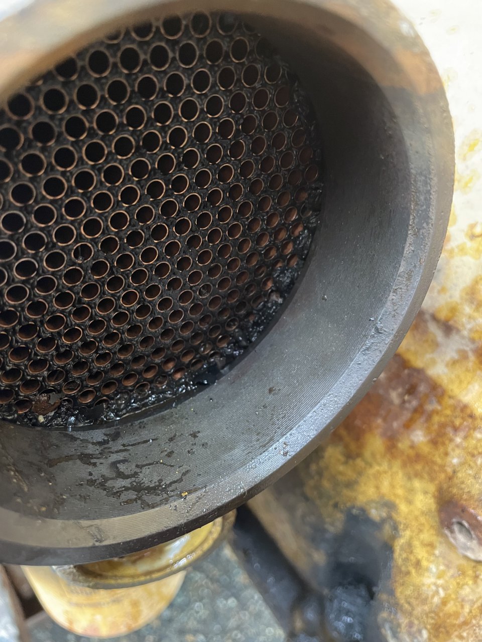

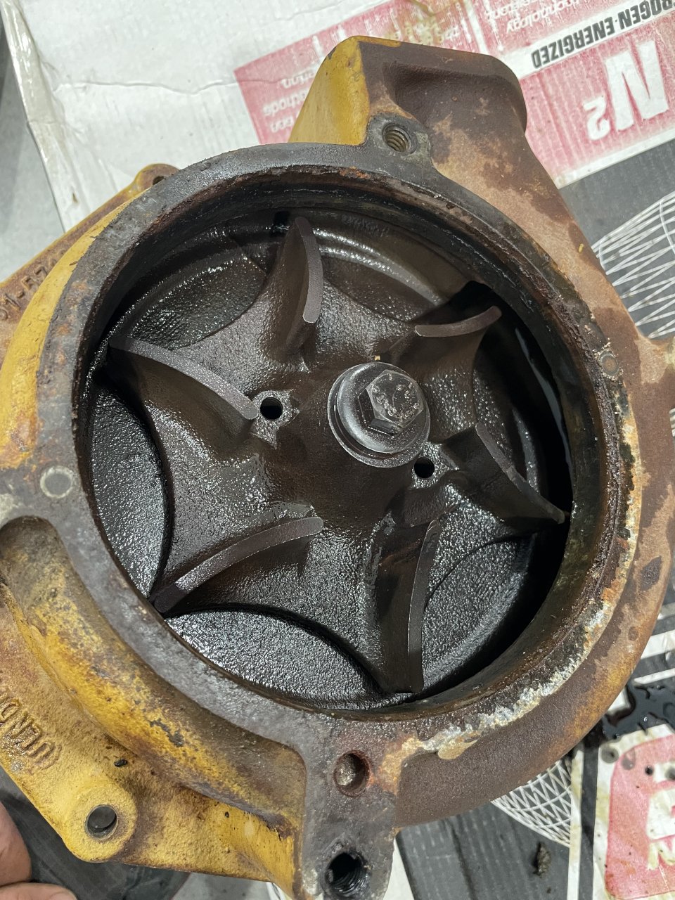

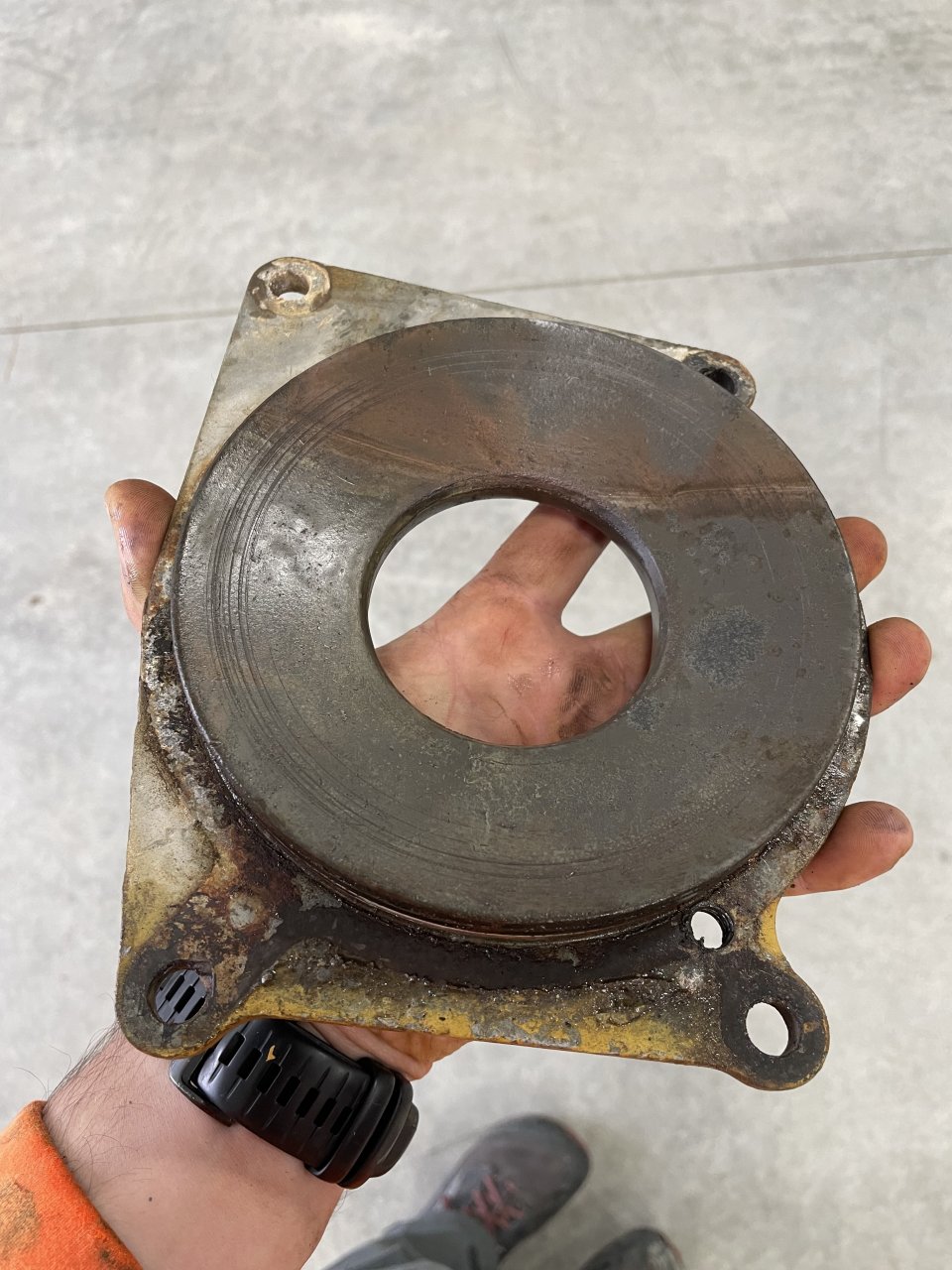

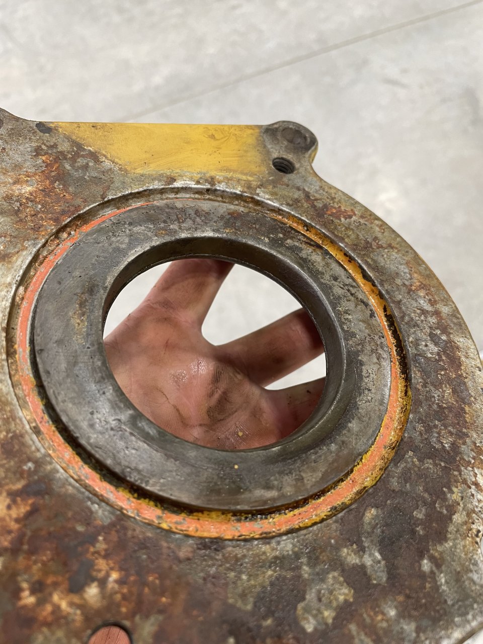

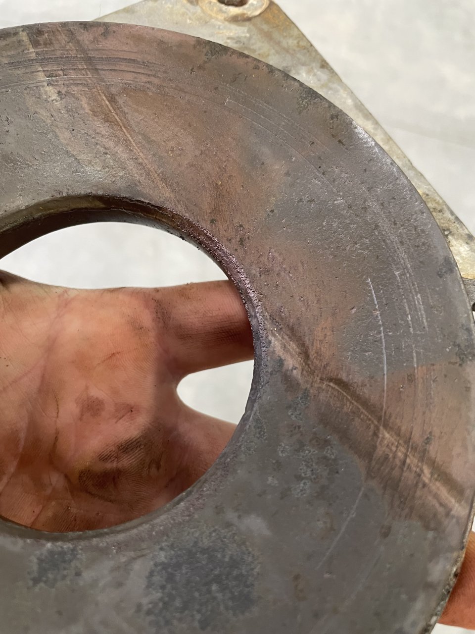

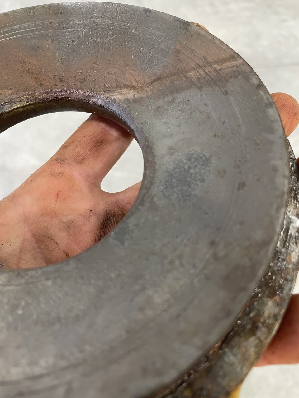

    I have finally got around to pulling the pump and backing plate. Attached are the pictures of each. Not knowing what exactly good or bad is like, the oil cooler is the only thing that looks funky to me. The rubberish type of material in front of it. I did pull the male-to-male o ring adapter and some of it crumbles out but most seems attached.

    @wore out do you see anything that would lower the pressure or should be replaced?
