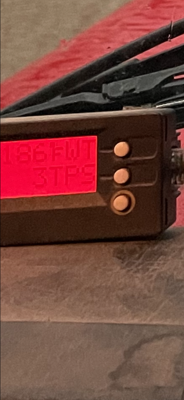

    1A336ECF-3395-4893-A29F-AA713835BF69.png Throttle position sensor. If you got a scan gauge that will tell you right away what’s happening with that. My TPS reads a 3 when I’m not touching the foot feed.

    Yea ima have to look at tps more I just kinda glanced at it. And I mean to say the black smoke is good that’s how it was running before I started having this no power no boost problem .when it acts up I don’t see any smoke at all and real sluggish no power .
