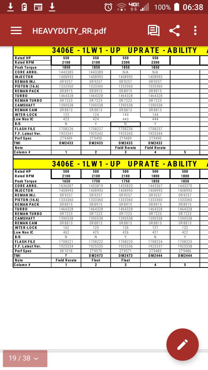

    My dealer showed me it was set at 550, even a friends scanner tool I used for my trim codes showed up 550. You think it might be a different computer on it? I’m not going to lie, at this point Nothing surprises me any more with this truck....
  9. spsauerland
    spsauerland Road Train Member
    4,296
    10,891
    May 31, 2010
    West Harrison, In

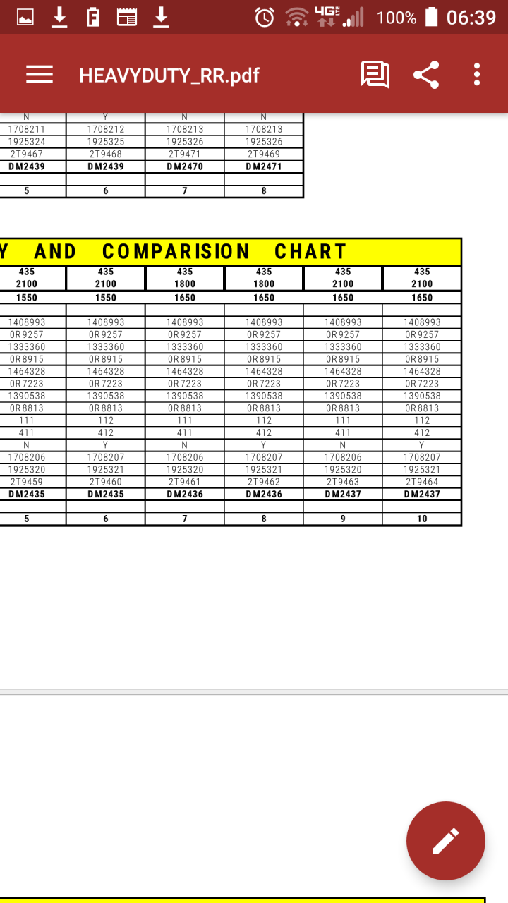

    To go from 435 to 550 on your 1LW, flash file was all that was needed. Screenshot_20191120-063934.png Screenshot_20191120-063844.png
    Just wondering if you have a Pre-low Nox file and if it is HH 2300 RPM one.
    pushbroom, Wheeljack, swaan and 2 others Thank this.
