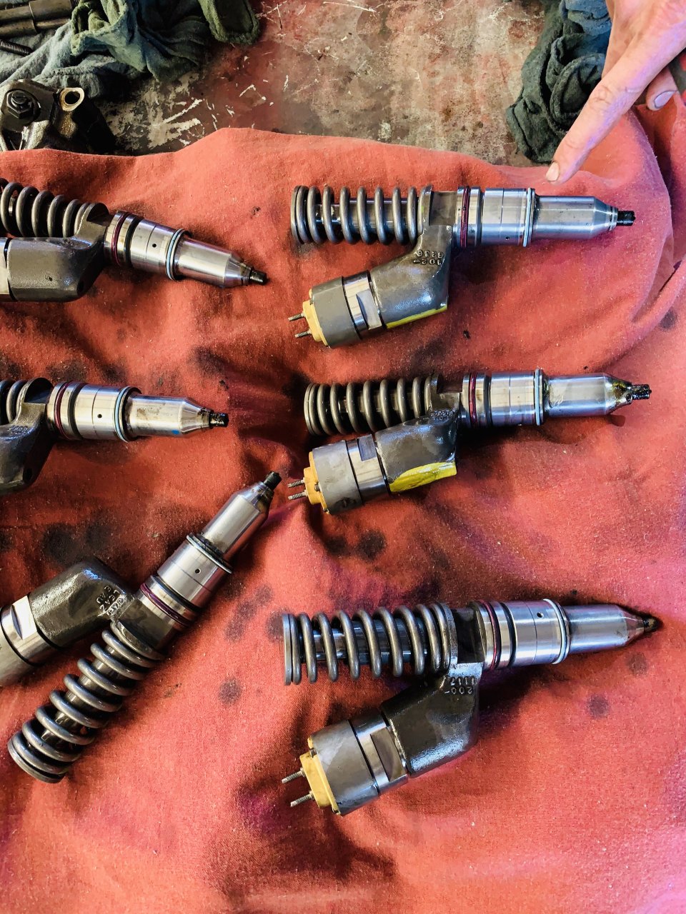

    Here is a picture of my injectors. I have a terrible vibration unload, sounds like a fuel knock, ruff low rpm sputter, idles fine, low exhaust temps when acting up. The motor even after I frame just never felt like my other 550 3406e. O a back story. The truck crack number 1 injector after owning it for a month. That’s why I install platinum kit. I at this point have replaced just about everything. Could the wiring cause these problems? The truck started to run weak about 2k milage ago

  13. swaan
    swaan Road Train Member
    2,942
    4,374
    Jul 12, 2009
    BC canada
    Theres no copper washers.
    The injector seats on the steel taper in the head.
    Your seats In the head are warped.
    You will never fix it until you have the seats machined in the head.
    There was a guy on here . Truck engine machinist. He can do the seats without taking head off. It's either this or replacing the head under warrenty with another reman.
    You will continue burning up the lower O-rings on your injectors till you fix this.
    Combustion gas's are getting by the seats and getting past the o-ring putting air into your fuel rail making it run ruff.
