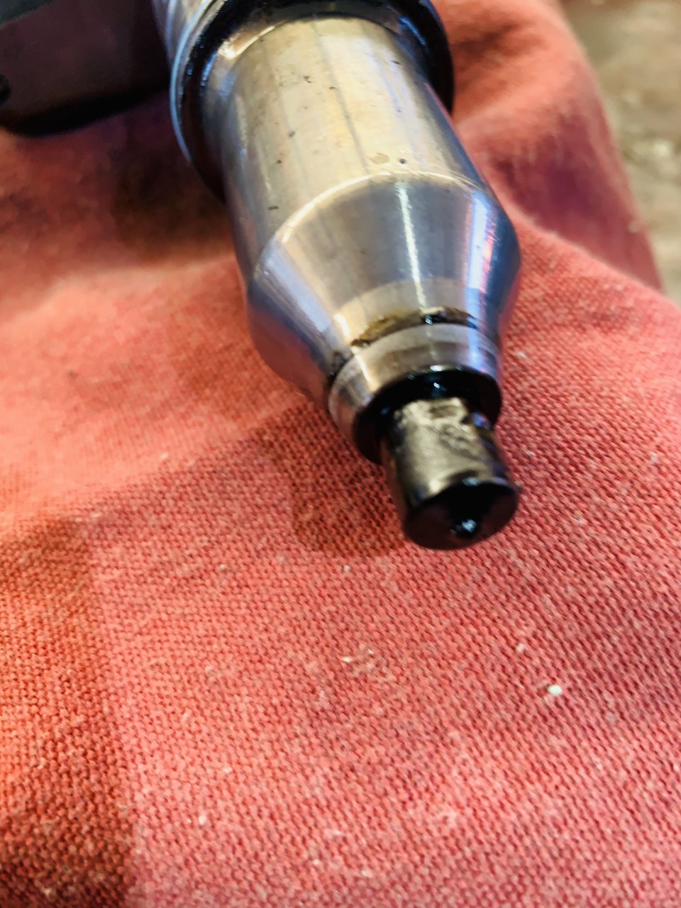

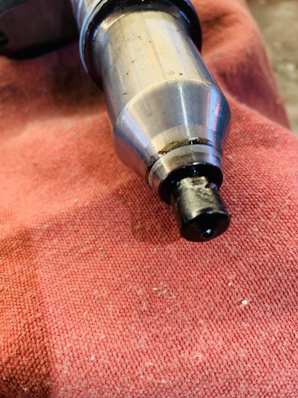

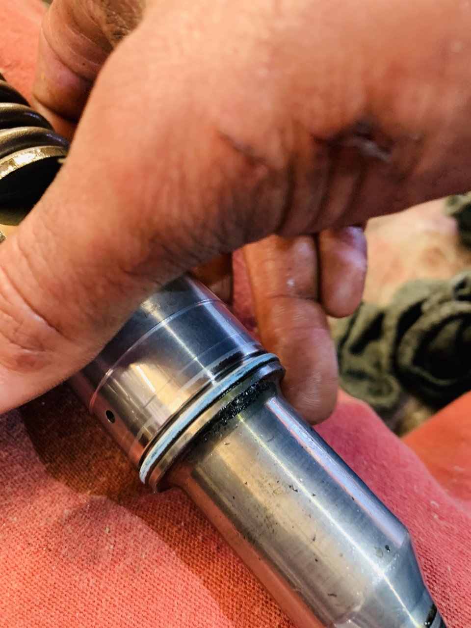

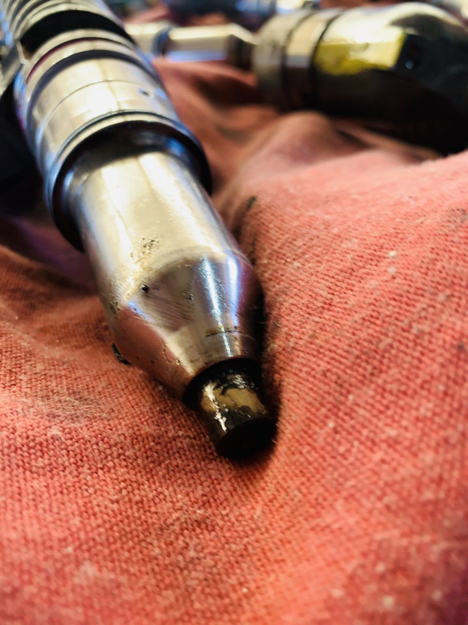

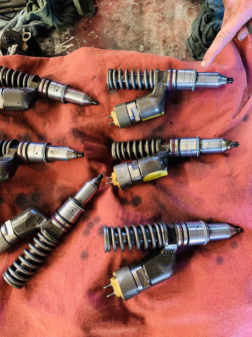

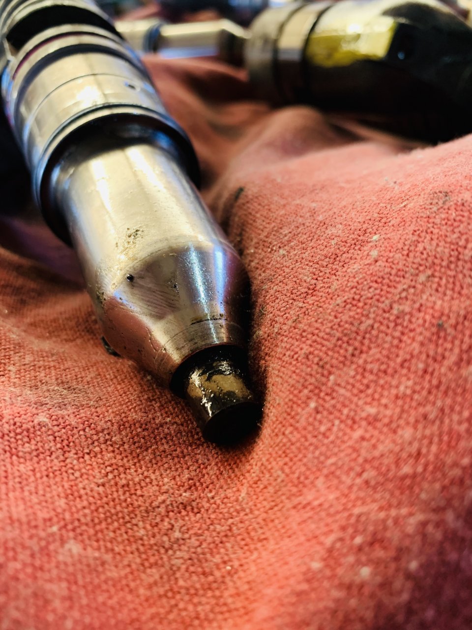

    I installed the upgrade transfer pump and transfer return valve. Basically acert parts, truck ran great, yesterday blow air throw the return line, and it was good. Return fuel flows out good I installed a new fuel cooler two months ago. It was leaking a little. Here is a picture of the Injectors when we took them out.

    That blue Oring looks like it's bad.
    I'd say seats need cut. Or replace head with another. Hopefully truck engine machinist gets back to you on this.

    Are you saying all 6 lower blue orings are bad?? Hard to tell in pics

    No there is a small o ring at bottom of picture, it’s missing on each injector. I’ve heard from other member it’s supposed to burn off..... all I know the truck exhaust temp are way way to low, it’s fuel knocking and has almost no power. I can’t afford for cat to have it for weeks to say it just needs a new head and have this happen again 30k miles over and over
