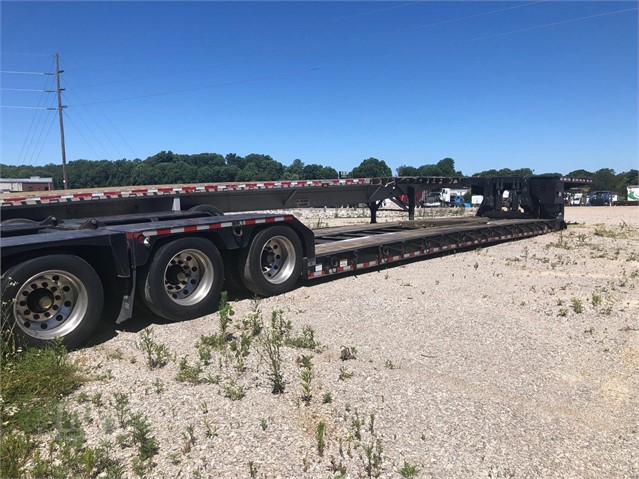

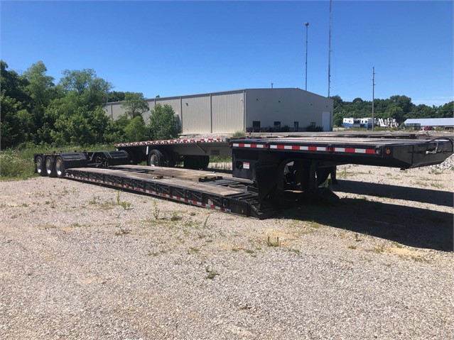

    i just bought this off brand no name (rampant=kaufman) 40T
    i have a 3 axle tractor AND a fixed 5th which i need to remedy, so i will severely limited on loading the steer
    the trailer weighs about 19k plus the flip so with the tractor i suppose i am 45k empty
    seems like i might be limited to around 60k because I can't get weight forward
    what do you all say
    60k tridem 34k tandem 10k steer = 104k minus 45k I am at 60k am i right

  9. Rontonio
    Rontonio Road Train Member
    6,549
    48,616
    Aug 9, 2009
    Not exactly correct. Here is what you will likely get… and what you maybe allowed depending on state. The 20K axle states are going to be you limiting factor - states like Nebraska and Oklahoma that do not allow more than 20k per axle.
    Assuming a 12 k steer axle (which you indicated) and the ability to slide forward some and backward some to adjust the weight transfer to the steer)
    12k Steer axle
    40K tandem drive axle
    60K tridem trailer axles (assuming you shim - and that the trailer allows you to shim - between the tandem and the flip axle to balance the weight across the group
    So that would 112k. Less you empty weight of 45k - you will be able to get to 67K ish payload - this will depend on the load and where in the well it sits and that you can position the perfectly.
    There are plenty of states that will allow 46k(assuming your axle/rear ratings are 46k) on a tandem (you would have to slide the fifth wheel further back to take weight off the steer. Then you could get to 118K gross or a net of about 73k. It is up to you to determine route and whether you can go to 46k on the drives.
    Then there are states that will allow you to go heavier on all the axles but the steer ( because you can never load your axles/tires higher than what the rating is) - places like OH, IL, WI all will let you go like 50K on tandems and 66k or more on tridems. But you you will have to load for the lowest axle group state you permit for.
    kylefitzy Thanks this.
