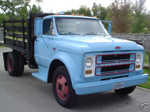

  11. MACK E-6
    50,245
    240,593
    Waxing a little nostalgic here, but the 4500 is pretty much supposed to be the modern version of this, right?
    Well, that C-40 looks like it was a tougher machine.
