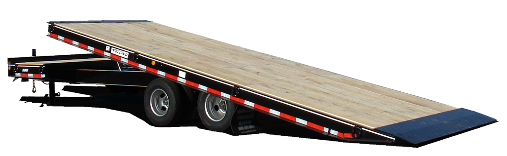

    @Bdog It seems like the trouble you are having is that the trailer is too long to get into some of the sites easily. How about something like this with a pintle hitch and a 28' deck....
    And use that to pull something like this for the truck. Always put the pickup on the trailer so if the truck breaks down you can still get the pickup off the trailer to run for fuel, parts etc.

    Can you set the tail end of the rollback deck down on the front of the trailer on a setup like that?
    I thought I've seen that done before...
  10. cnsper
    cnsper Road Train Member
    5,869
    27,421
    Feb 28, 2014
    I don't see any reason you couldn't
