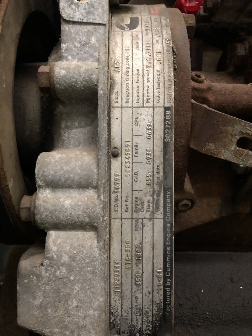

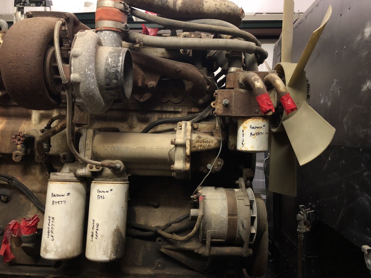

    B1F486F3-088E-494F-9187-485E22271BE0.jpeg AFC13EA4-1324-441C-82F2-A9CB4ADC892E.jpeg 748695C9-9134-4B95-8268-BED87E2F286E.jpeg Here’s mine. It’s on my list of things to get done. Hoping that one new cylinder kit is all it needs to run again. You can see the heat mark on block at #5. I have all the early BC3 stuff to convert it back to FCC to put it in my 352 Pete cabover.
