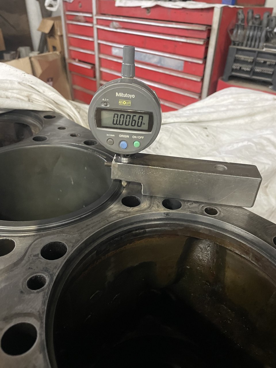

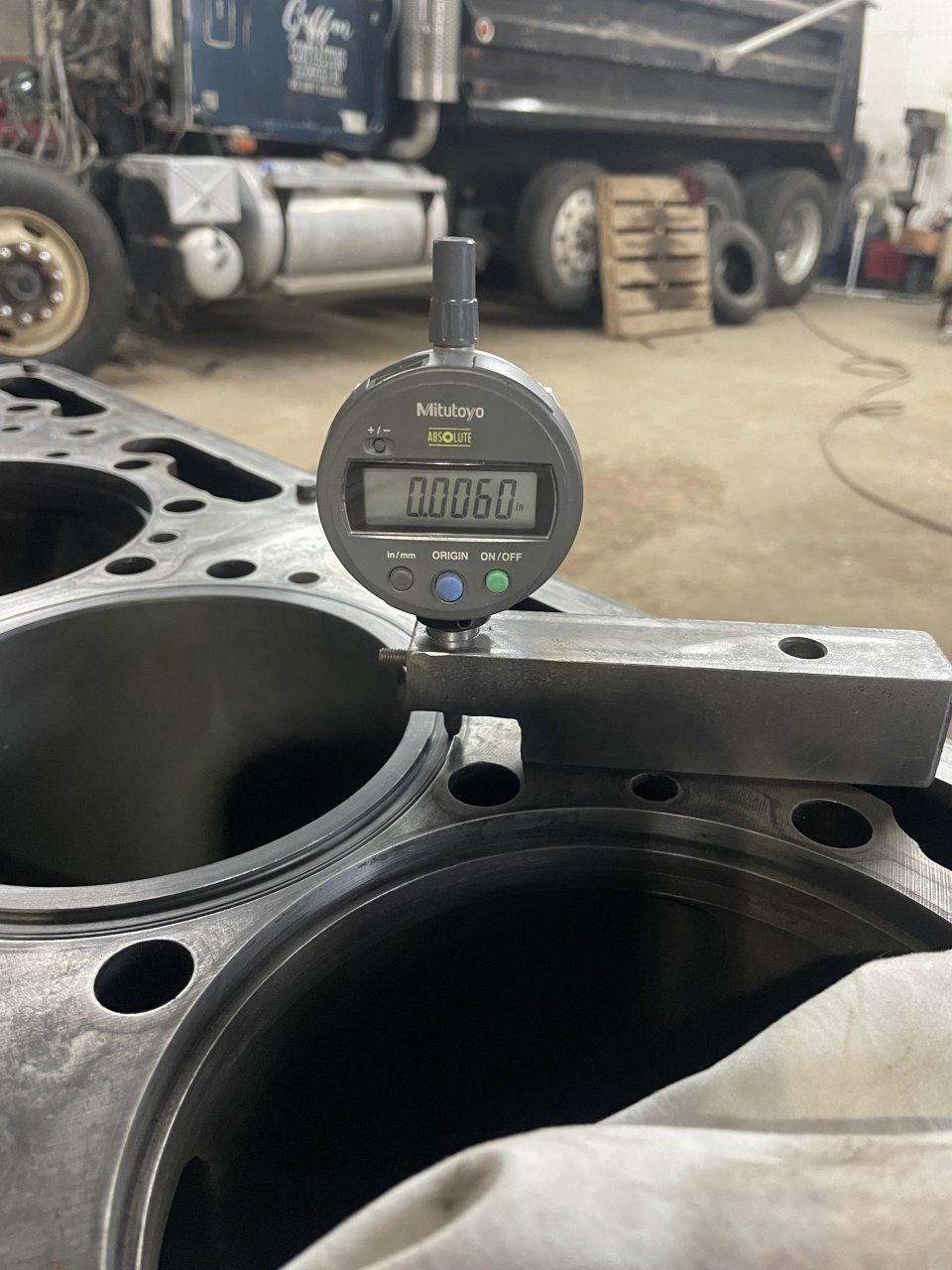

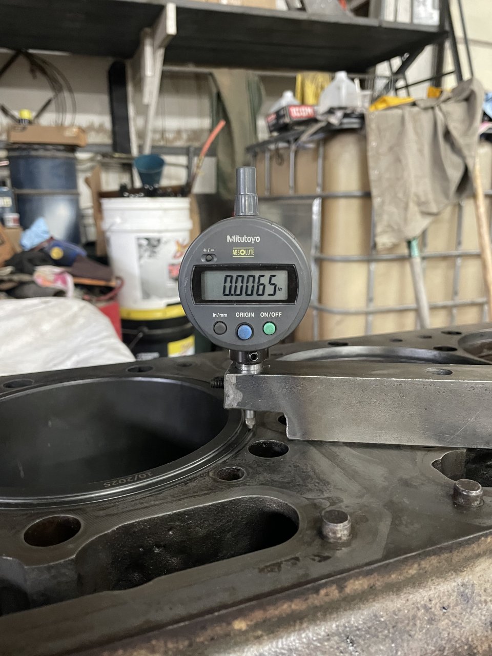

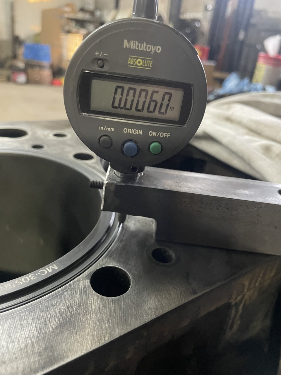

    Pressed a liner in with no o rings or shim. IMG_7627.jpeg IMG_7630.jpeg IMG_7629.jpeg IMG_7628.jpeg

    couple things i observe. you should still have pressure on the liner while measuring the protrusion. whether it’s a press and plate or bolts with washers.
    secondly it may be nicer to have a more pointy tip on your indicator so you know exactly where it’s touching and not getting a false reading from a ledge.
    third is that liner is the looks like the newer style with a flat-ridge-lower flat. i have never seen a straight answer whether should be measuring on the very outside of liner or just inside of the ridge. inside to outside of ridge is about .003” difference

    I’ll agree that the tip could be more refined. I’ve also got and use and old Starrett dial sled. Preciate the help.

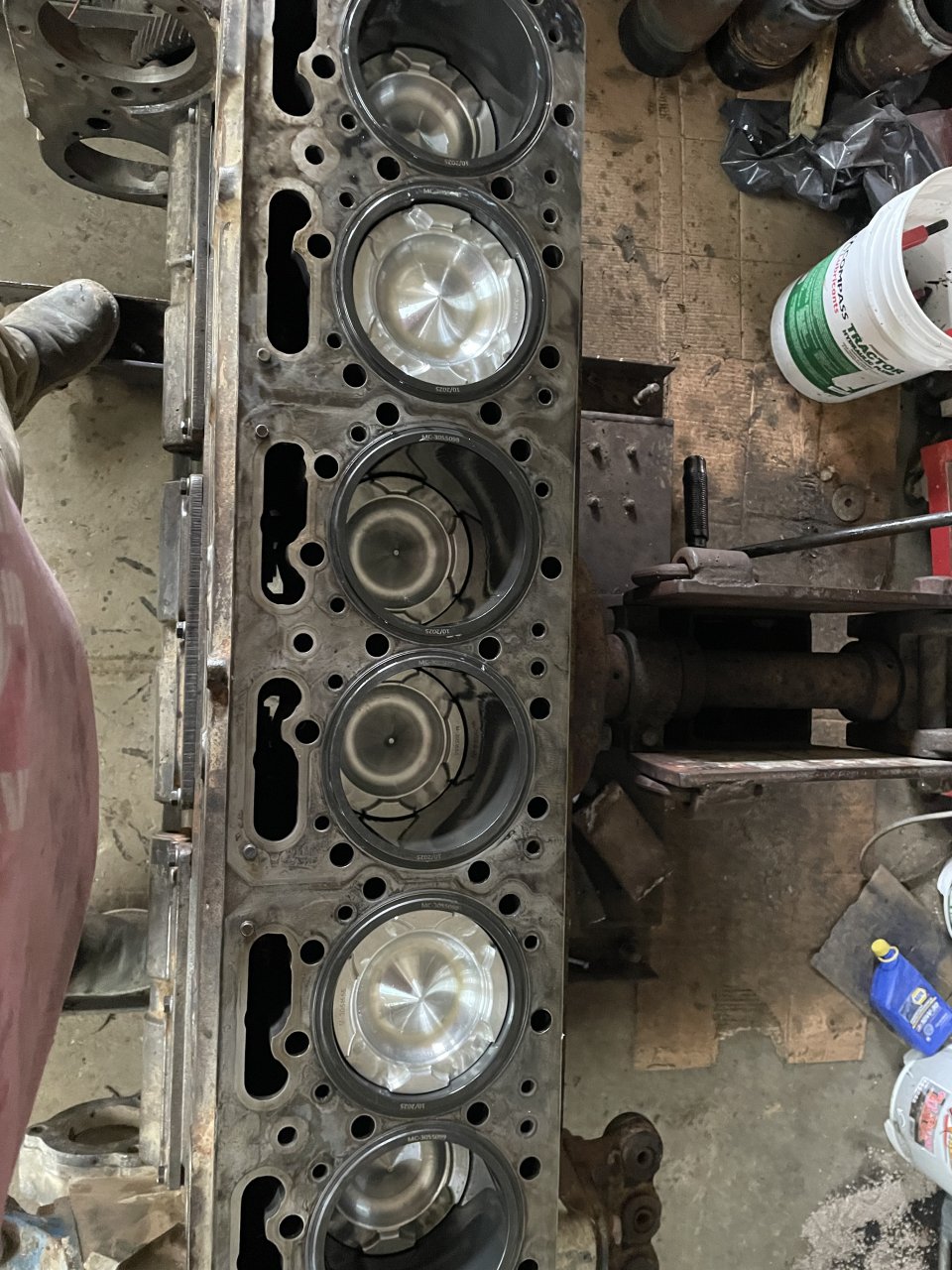

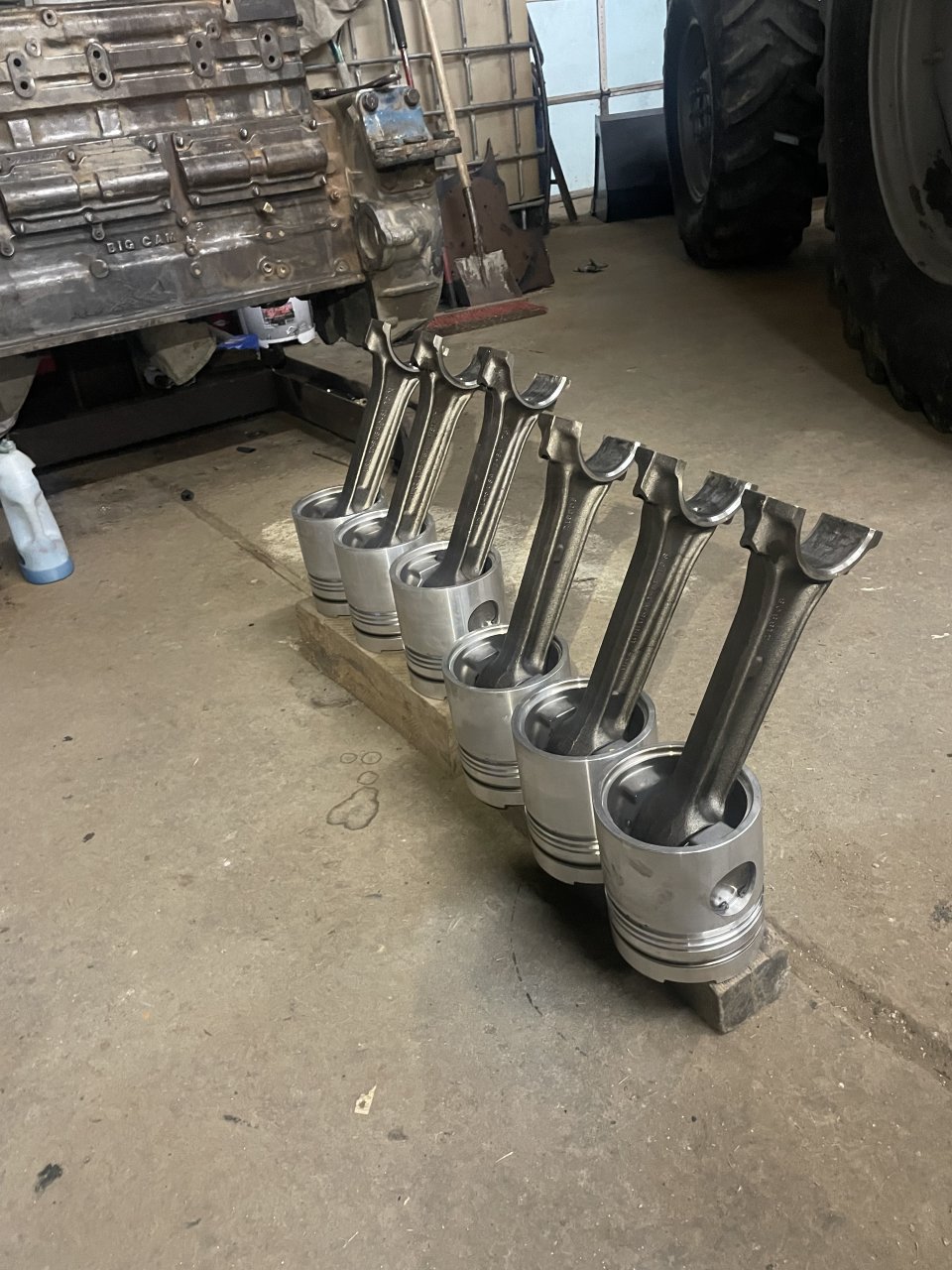

    IMG_7664.jpeg IMG_7665.jpeg IMG_7674.jpeg Liners are pressed in, pistons built and dropped in.

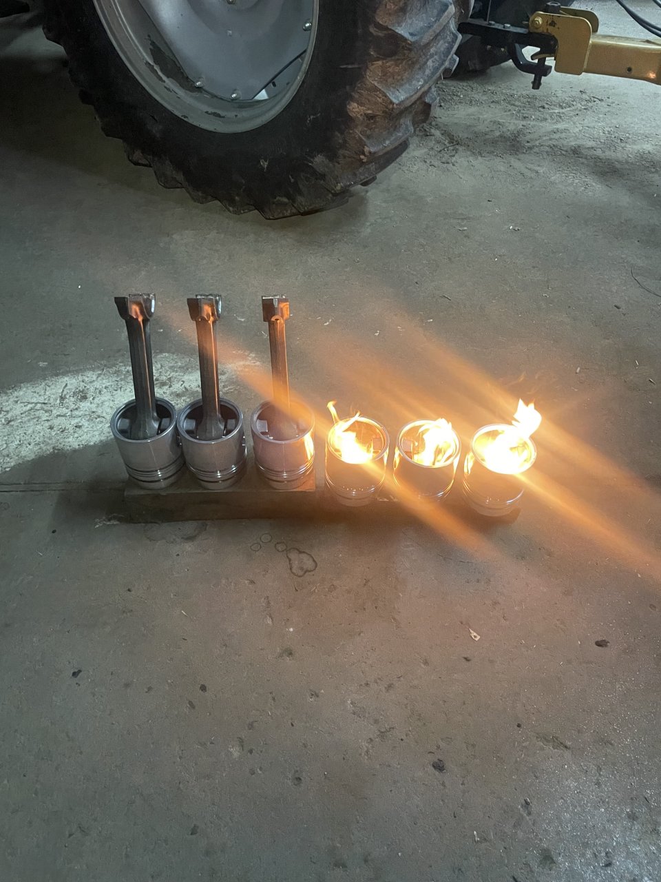

    When they connected the piston, rod and pin together, they had me boil a pan of hot water. He dropped the piston in the hot water for a few, pulled it out and the pin slip easily as if it was lube.

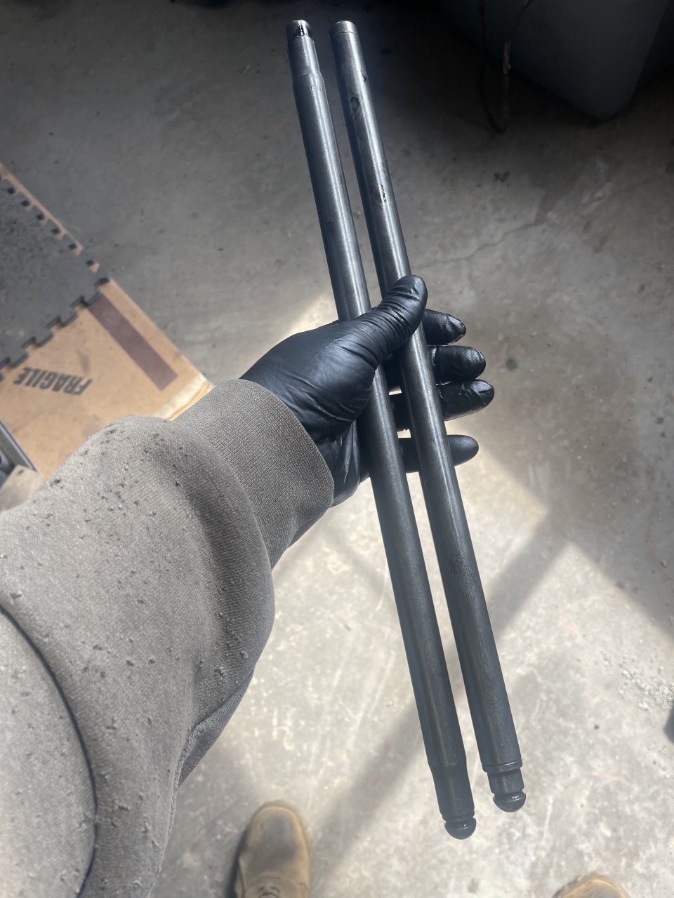

    Got to checking my push tubes and noticed two of my injector tubes are different than the other four. The tube on the right is the style that there’s only two of and its part number is 3032681. The one on the left, that resembles the others is, 3027214. I don’t notice anything different about the rocker boxes but I’m in the process of cleaning them. IMG_7680.jpeg
