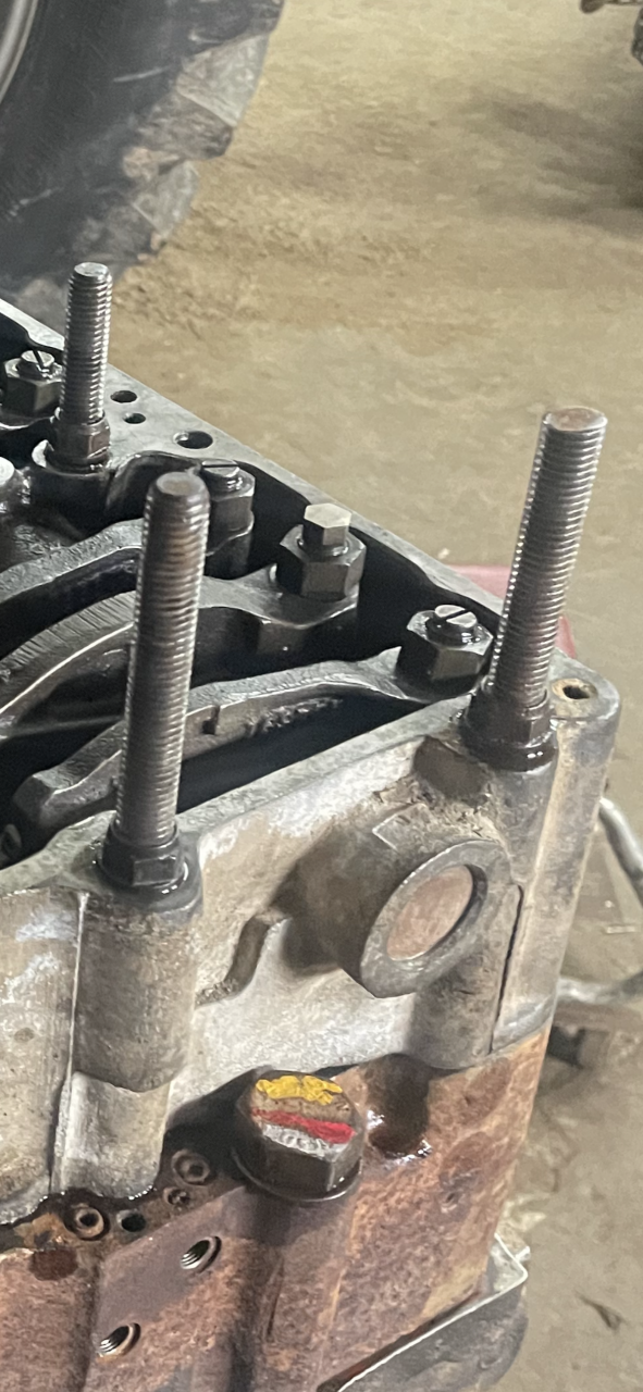

    Are y’all using an extra deep socket to torque these long rocker box/Jake studs? IMG_7717.png
    Big Road Skateboard Thanks this.
  3. dmax17
    dmax17 Bobtail Member
    5
    1
    May 23, 2016
    torque adapter at 90* on torque wrench.
  4. Big Road Skateboard
    7,138
    40,448
    May 2, 2021
    I do.
    mile marker 27 Thanks this.

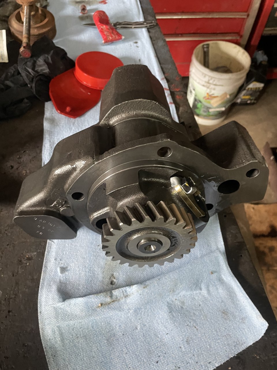

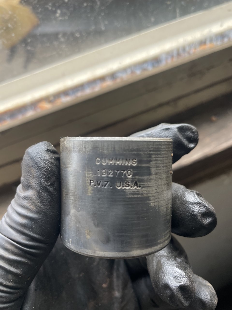

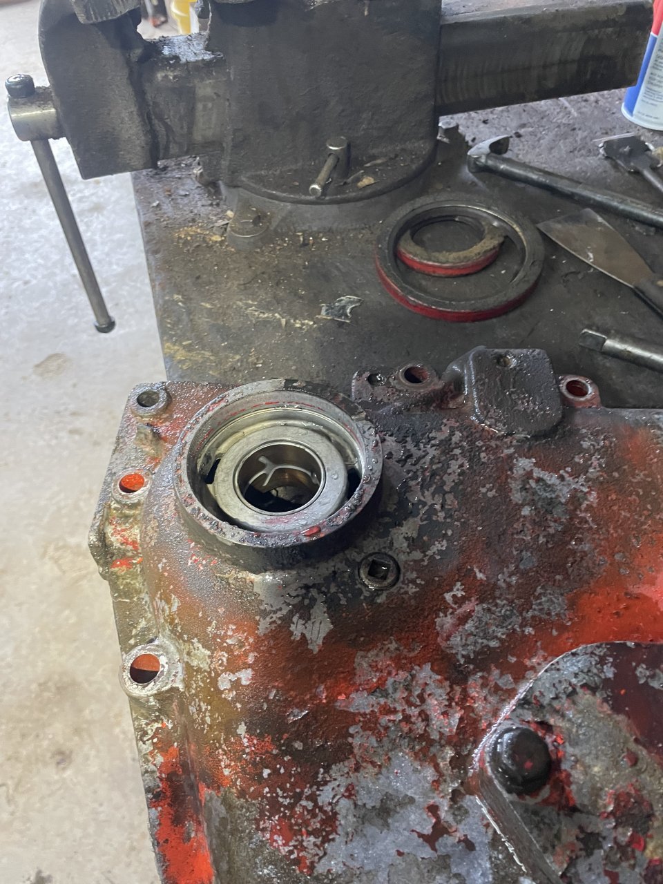

    Well, my time to work on this project is becoming very limited with farming but the new oil pump finally arrived, along with water pump. Drove out the old accessory drive bushing and going to replace it. There’s a washer behind the cam gear but didn’t notice anything between the cam/cam gear and front cover. I don’t remember there being a thrust washer used there?
    Do ya’ll happen to know the part number for the little rubber plug, that goes between the accessory drive keyway and the nut/flat washer, that holds the pulley on? Thank y’all. IMG_7783.jpeg IMG_7784.jpeg IMG_7785.jpeg
