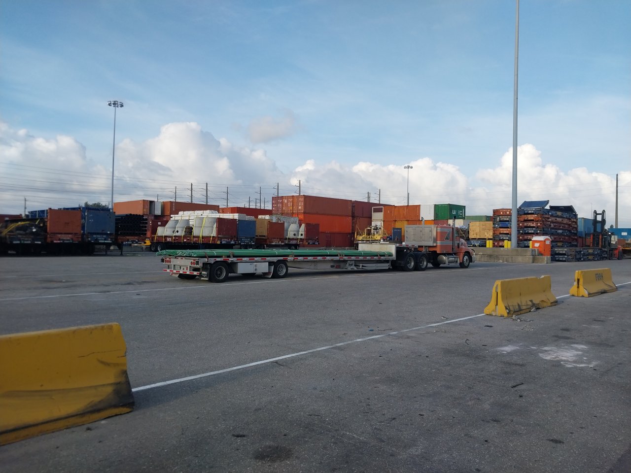

    Not trying to be rude, but a 53' fixed spread is one goofy look'n wagon, only on par with a 53' fixed spread highboy.. :confused:

    Get a slider if you can find one.

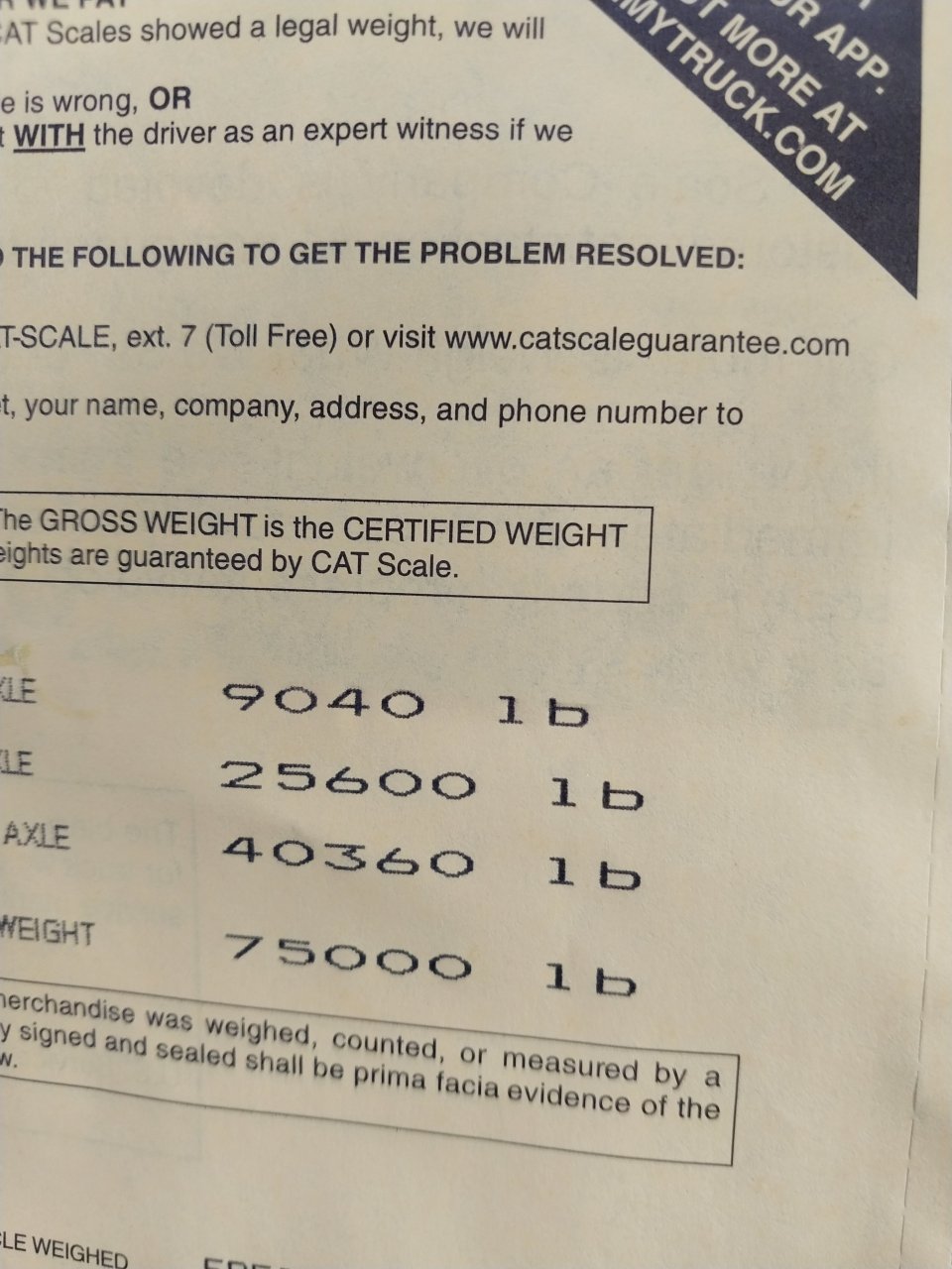

    Longer loads such as 40'+ rebar, pipe, 40' heavy containers, anything long you can't use load levelers with you'll end up over weight on the spread..
    I'm a fixed spread 48'. 8'upper 40'5" lower & 46k lb 40' rebar had my spread 360lb over & only 75k gross..o_O That set foward fixed 53' would be way over 40k lb back there..
