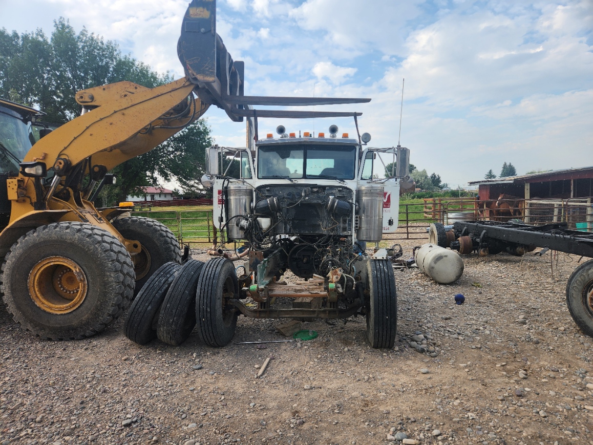

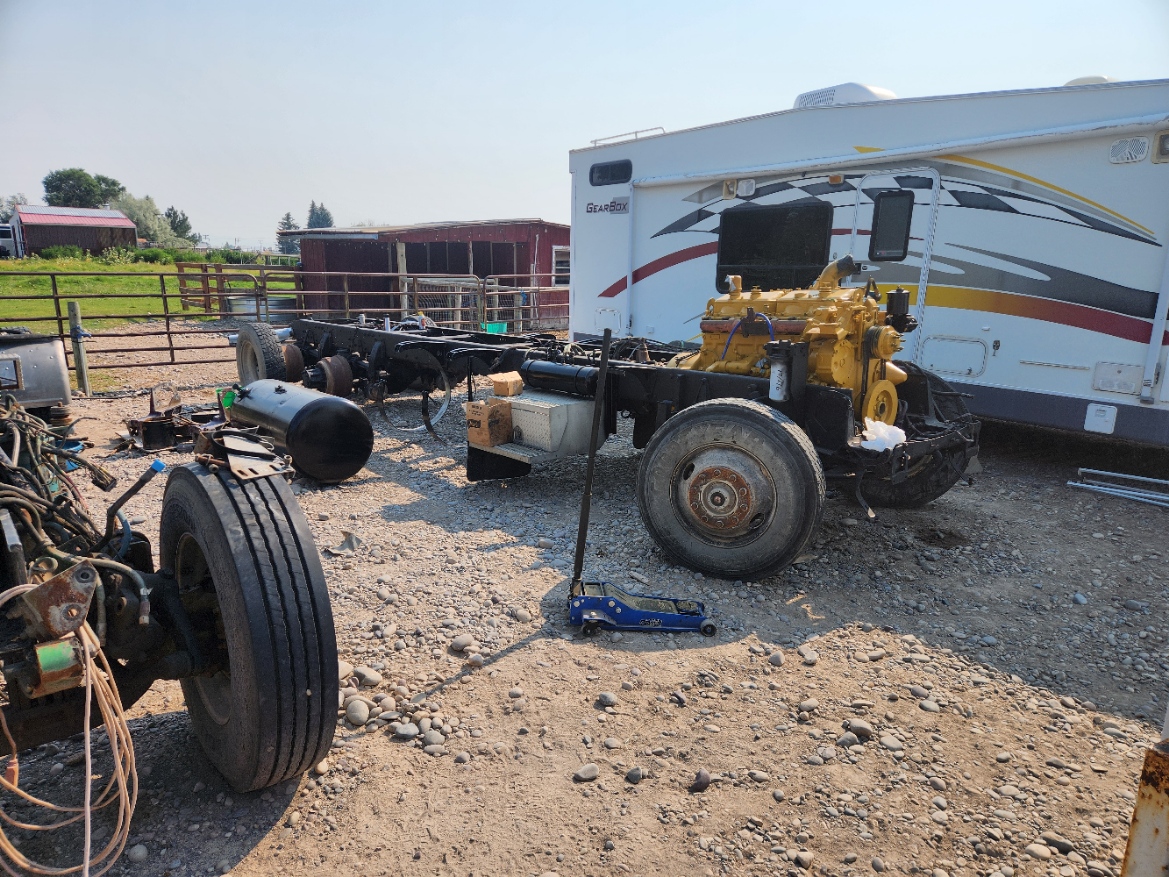

    We're plugging along as time permits. Got the cab off the other frame, transmission and driveline installed in new frame, and a bunch of plumbing done. We are squirting things black as we go as well. upload_2024-7-16_18-12-23.jpeg

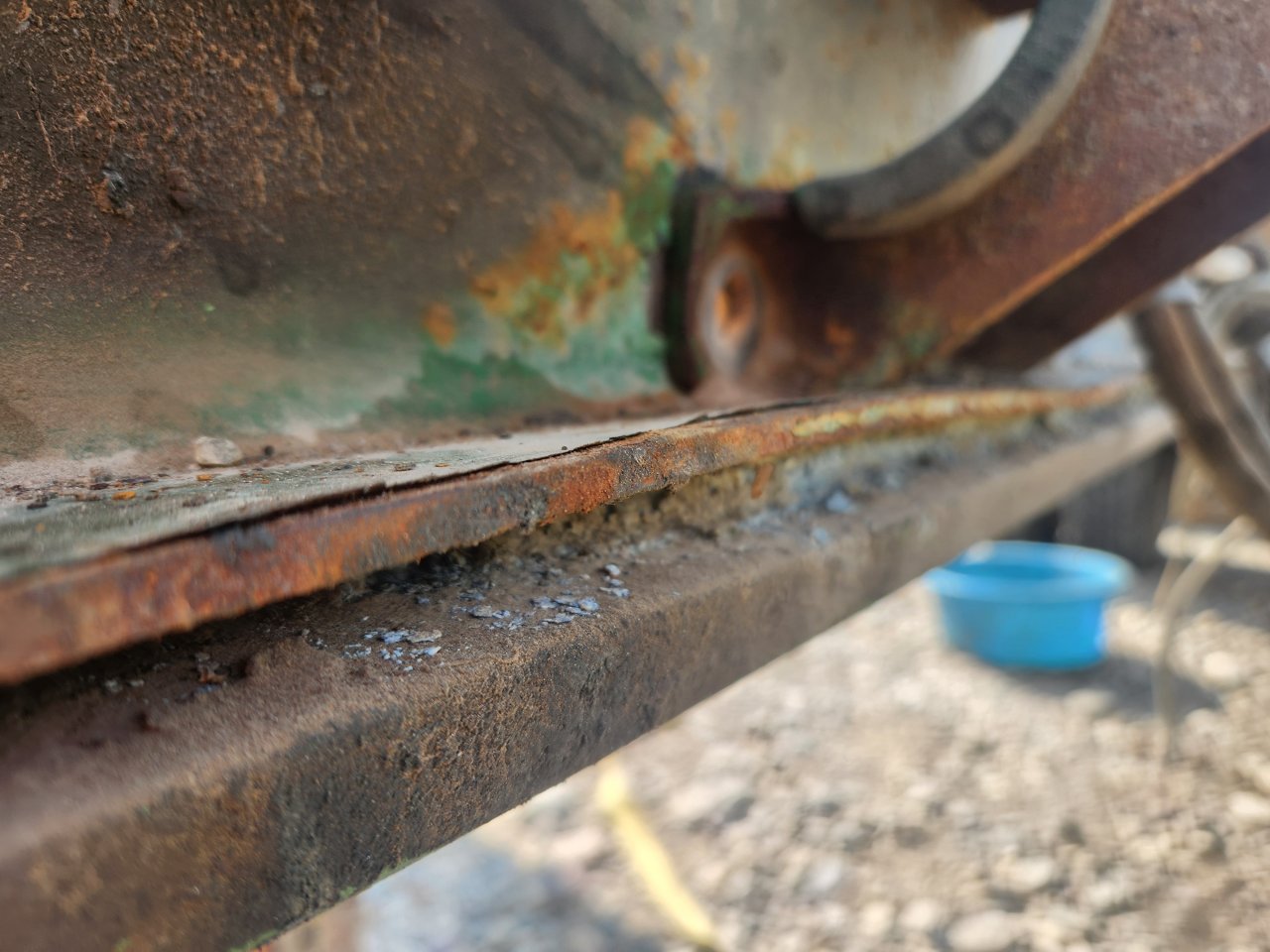

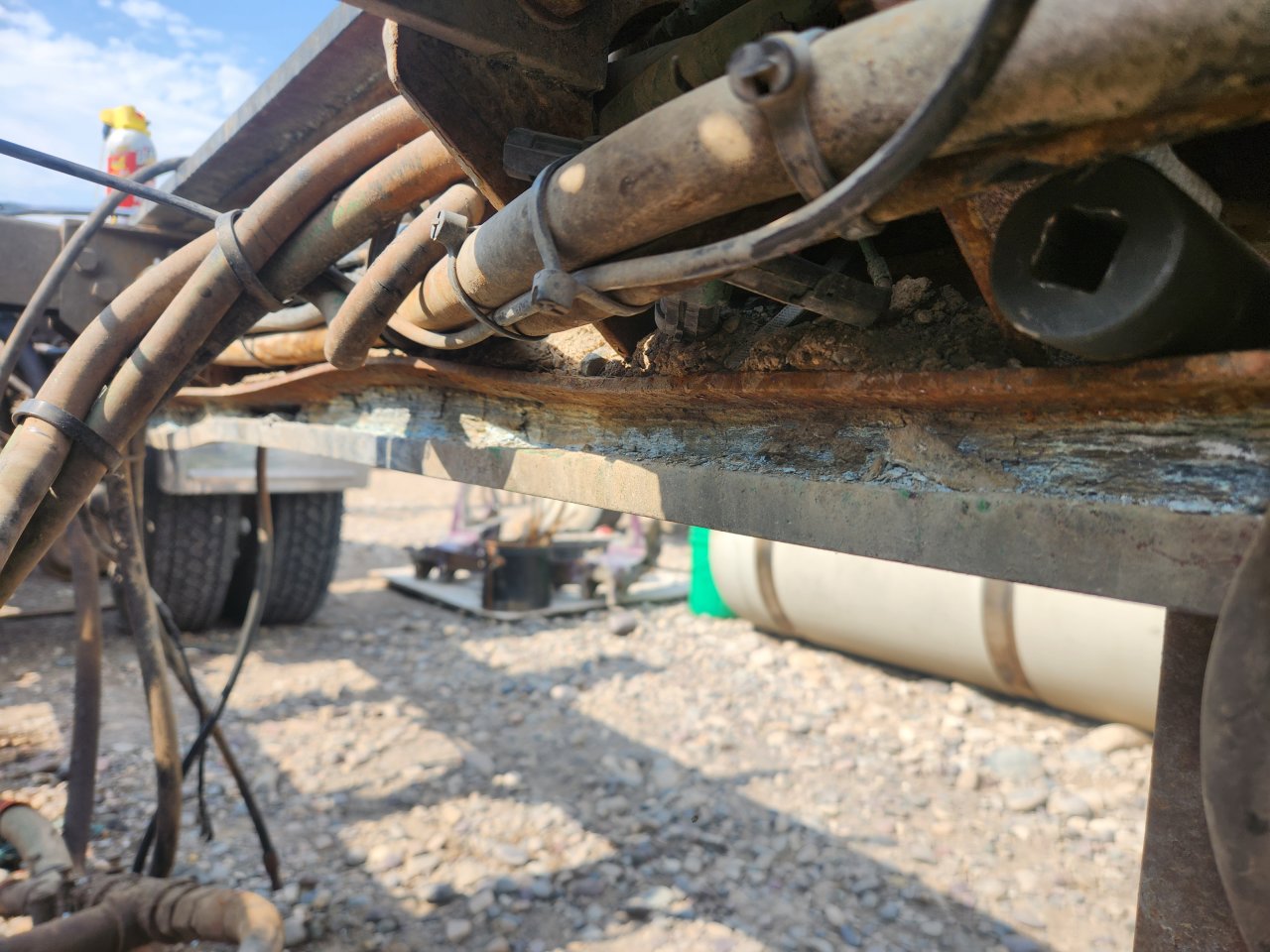

    The donor frame is aluminum and rust jacking consumed it. 20240715_101305.jpg 20240715_101310.jpg
    This was an 89 379. I found a rolling chassis that has a steel frame and came with the block that we rebuilt. It was also an 89 379, with nearly identical wheelbase. So now we are swapping everything from the donor truck to the new one, including fuel tanks, battery boxes, etc.

    Don’t loose that socket
  6. ElmerFudpucker
    7,379
    80,924
    May 17, 2024
    And aluminum frame rails are supposed to make great outrigger boards
  7. Oxbow
    Oxbow Road Train Member
    13,913
    145,059
    Nov 24, 2015
    I noticed that too and went out to make sure it wasn't still there. I put everything away each night so usually a missing socket is apparant, but you never know.

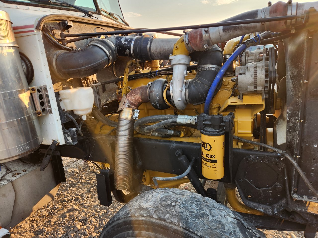

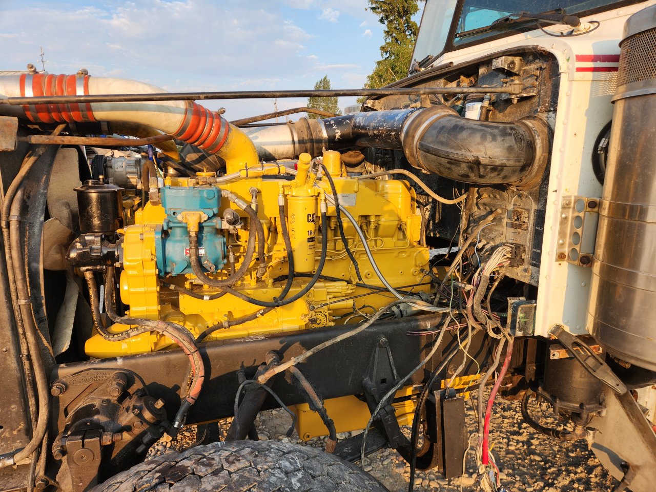

    A little more progress. Lots of little things that take time, but we're gaining.

    Me too! With a retarder the block mounted filter was a bugger to change.
