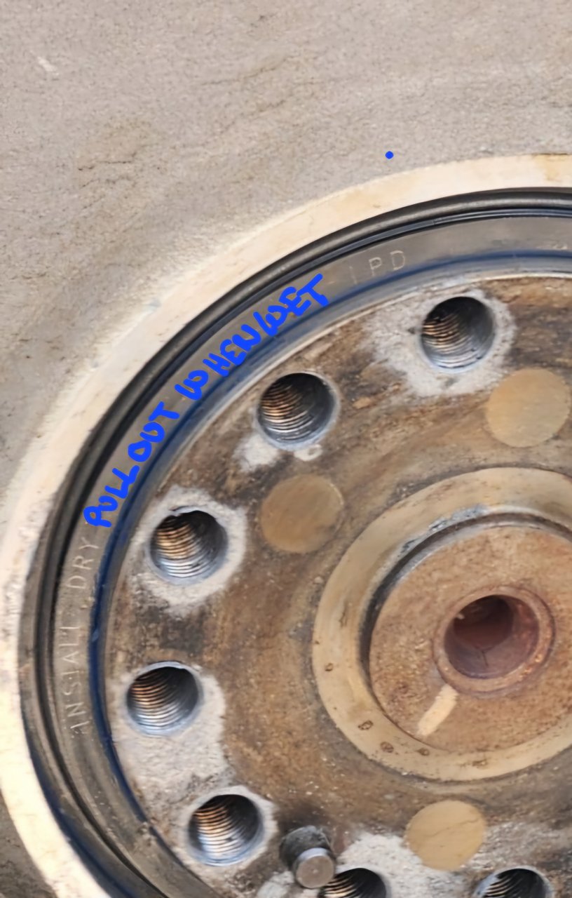

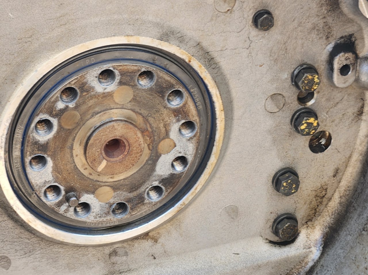

    So, this was Thursday evening:
    And this was yestedrday:
    See anything wrong with the progression here?
    All because the GD boss, who went overboard to make sure that everything inside the block was done to perfection, or at least no detail was skipped, decided that when it came time to put the rear seal in he didn't need to get the special tooling to install the seal. F'n ahole!

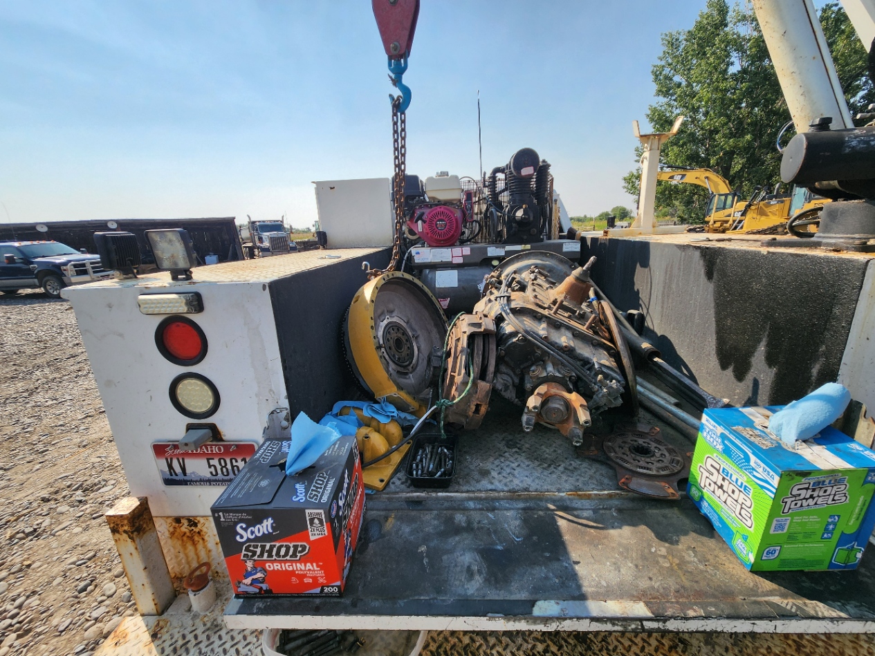

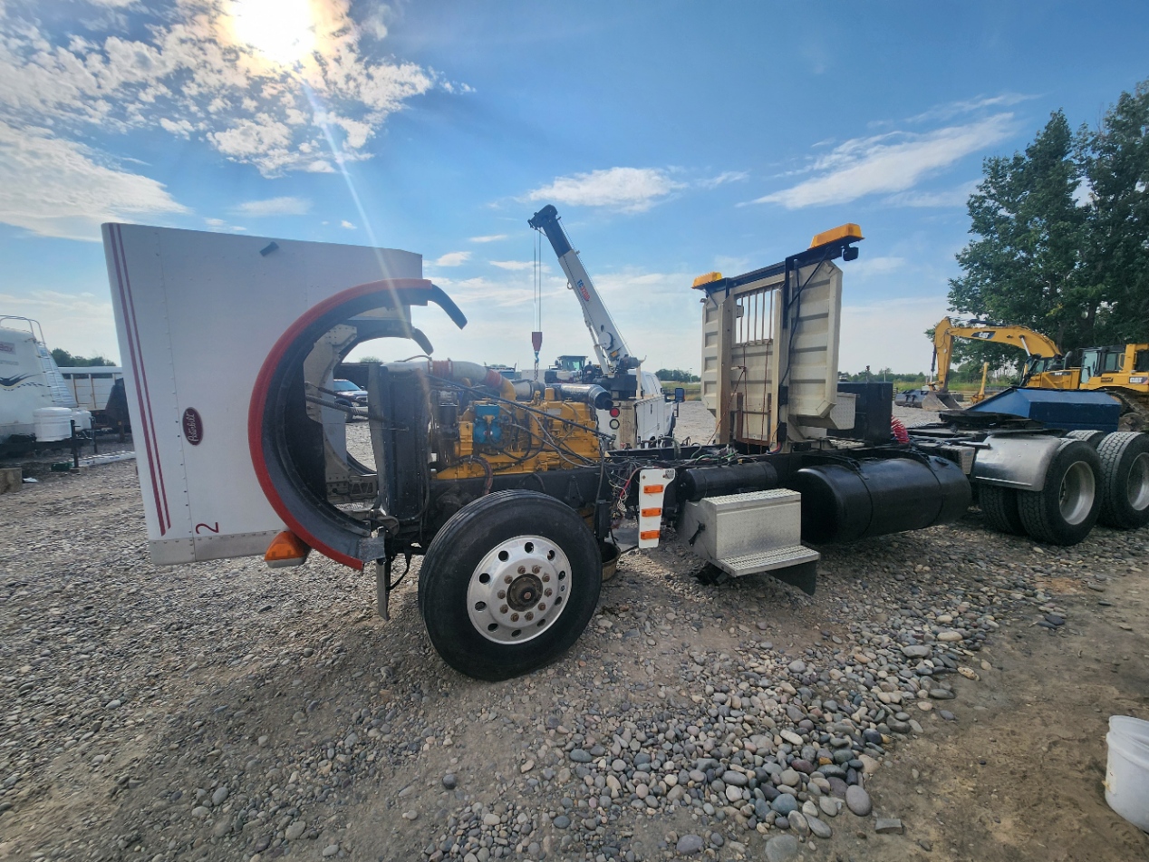

    Hey, we can now remove the cab, transmission, and retarder in 3.5 hours!
    I don't have a transmission jack, nor a concrete area big enough to use one, so we decided it would be faster for us, in our situation, just to pull the cab.
  8. Big Road Skateboard
    7,511
    42,972
    May 2, 2021
    I know that F'er too. We must work for the same guy.
    A wee bit crooked in there?

    What a f'n idiot I am, but we'll get it right. Ordered the dang tool Thursday night and have a new seal in hand.

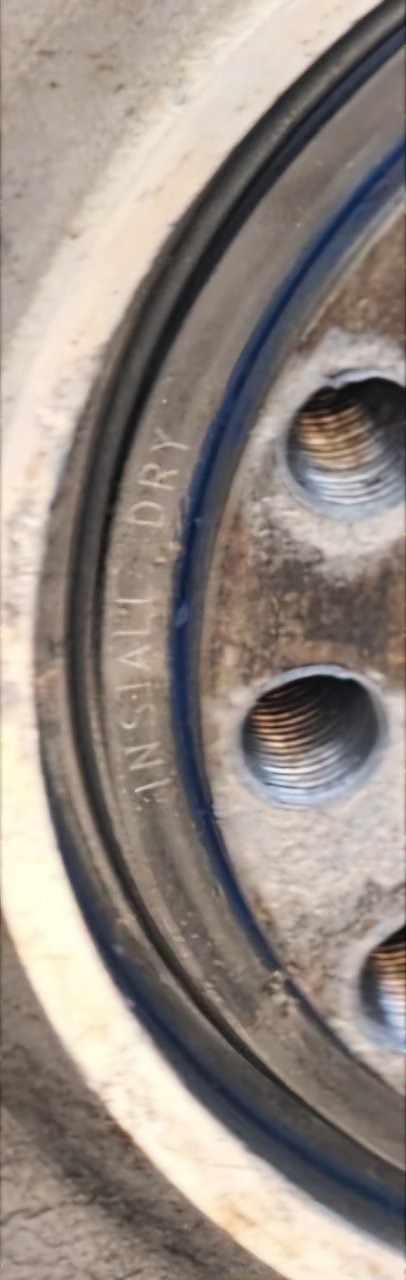

  11. Big Road Skateboard
    7,511
    42,972
    May 2, 2021
    After reading the fine print, the seal says install dry. Look a little closer and you'll see step two.
