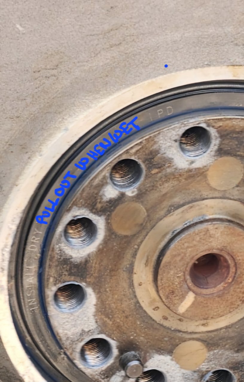

    Hey, not sure where you ordered the seal installer, but most nowadays come from China.
    After the seal starts into the bore, pull the installer body back off and make sure it's started straight.
    I've come across a few that weren't square and pushed the seal in crooked. You can see it real well when the wear ring gets flush with the crank.

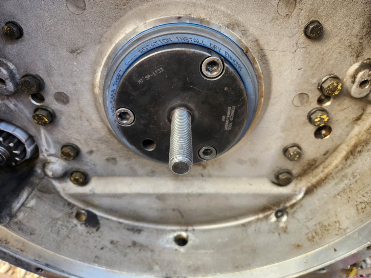

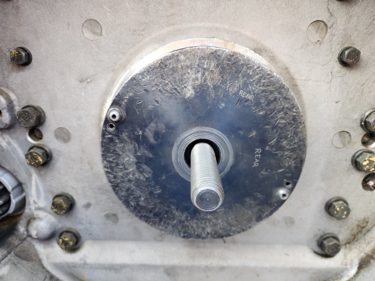

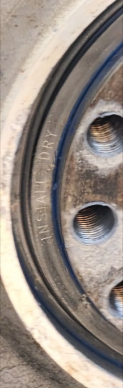

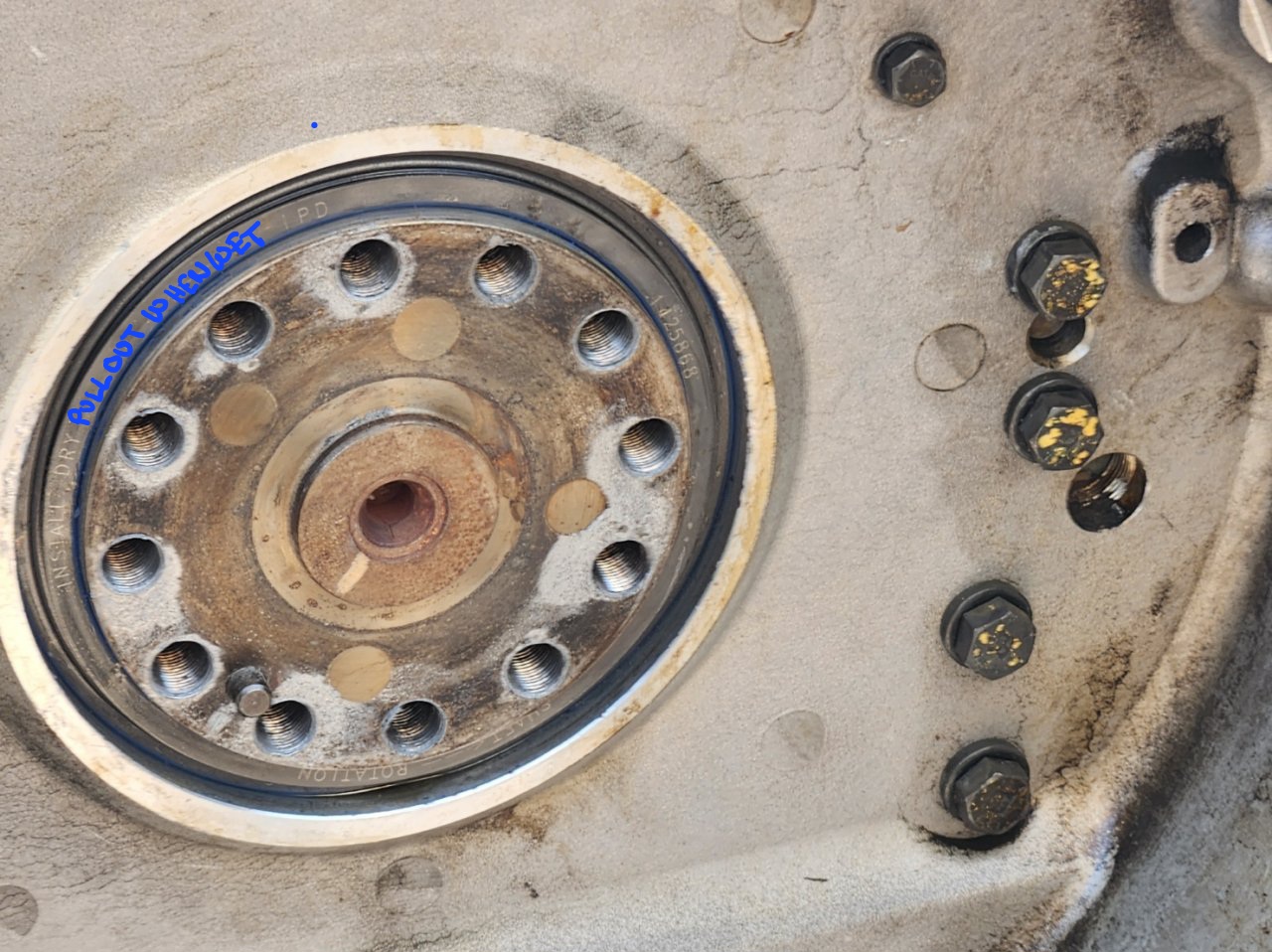

    Anyway, most all that read this thread are much smarter than me and know how to do things properly. In the event that someone is reading this that is interested, here are a few photos:
    Rear end of crank:
    Note the dowel. This insures that the flywheel goes on correctly for pin timing.
    Inner seal guide.
    Push plate for rear seal that pushes both inner and outer seal segments at the same time, preventing damage to the seal and pushing the seal in to the correct position.

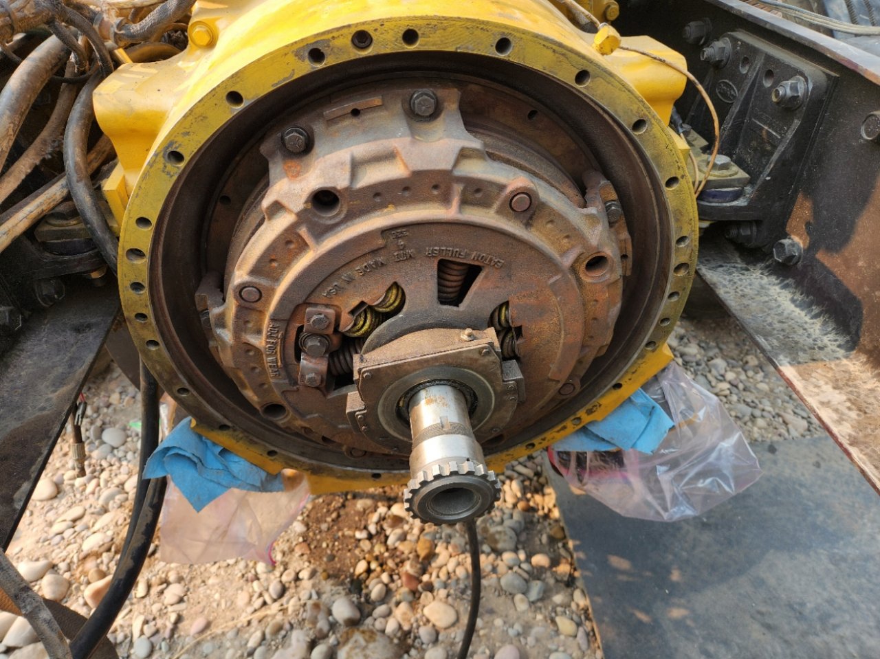

    Closer look at easy pedal clutch adjuster. @mitmaks had some issues with one recently. Perhaps this will help others like me that don't really know WTF were doing! Lol
    upload_2024-8-7_17-39-8.jpeg Clutch installed.

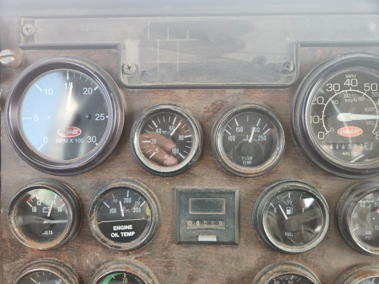

    They say to break a new engine in by working it. I'm going to give her a pretty good first trip tomorrow. About 112,000 lbs.and going about 100 miles from 4500 ft. to 6500 ft. Should seat the rings I hope!
  11. Oxbow
    Oxbow Road Train Member
    13,835
    143,805
    Nov 24, 2015
    The new engine and turbo performed very well. Pulled good and never saw more than 750 on the pyrometer, and the boost was about 33ish pounds at wot. Turbo is what @wore out recommended - 1.45 ar and 78mm non wastegate.
    I stopped at the closed scales on the way and got a free weight. About 13000 on the steers, 44000 on the drives and a little over 54000 on the trailer, so just a bit over 111,000. No long steep hills where I went, but a steady light pull for the most part of 100 miles.
