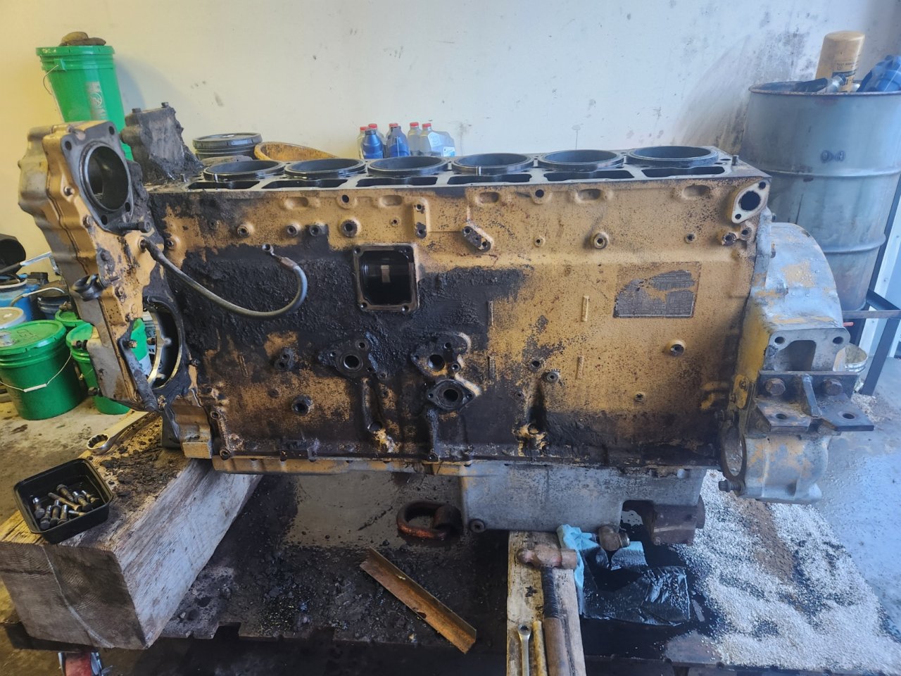

    "the crack would reappear each time and extend a little further" Ends of a crack are high stress points. Would have had a better chance drilling at the ends of the crack to relieve stress then welding. The method is called stop/end drilling. Too late this time. You mentioned Lock and Stitch, there are others such as Irontite crack repair.

    The problem was the fear of drilling clear through the block into the oil gallery abd getting shavings in there. We could have dropped the pan and tried to collect shavings, and tried to flush them out of the oil gallery, but rather than take that gamble we opted to start with a better block.
    I'm not disagreeing with you. Access to the area while in the frame was challenging, so once we pulled the engine we chose to start with (I hope) a better block.
