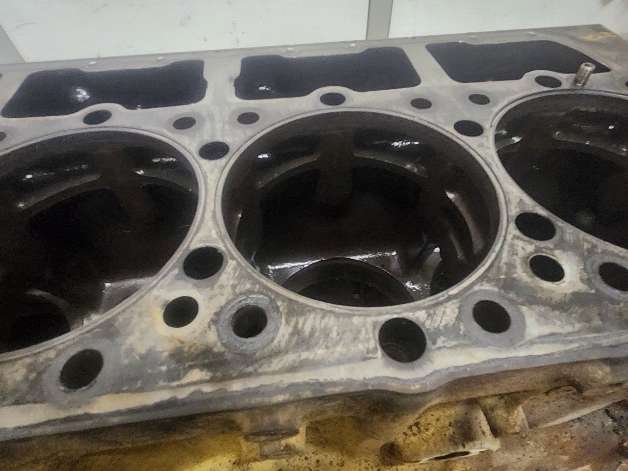

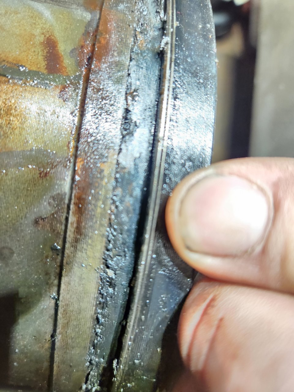

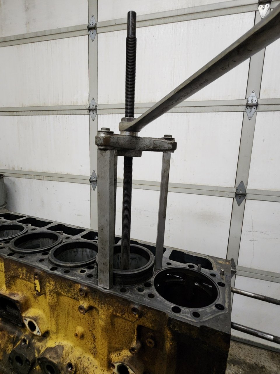

    Ok, liners are pulled.
    There is some evidence of electrolosis on the outside of the liners, but not horrible considering we have no idea of the history. This was probably the worst liner.

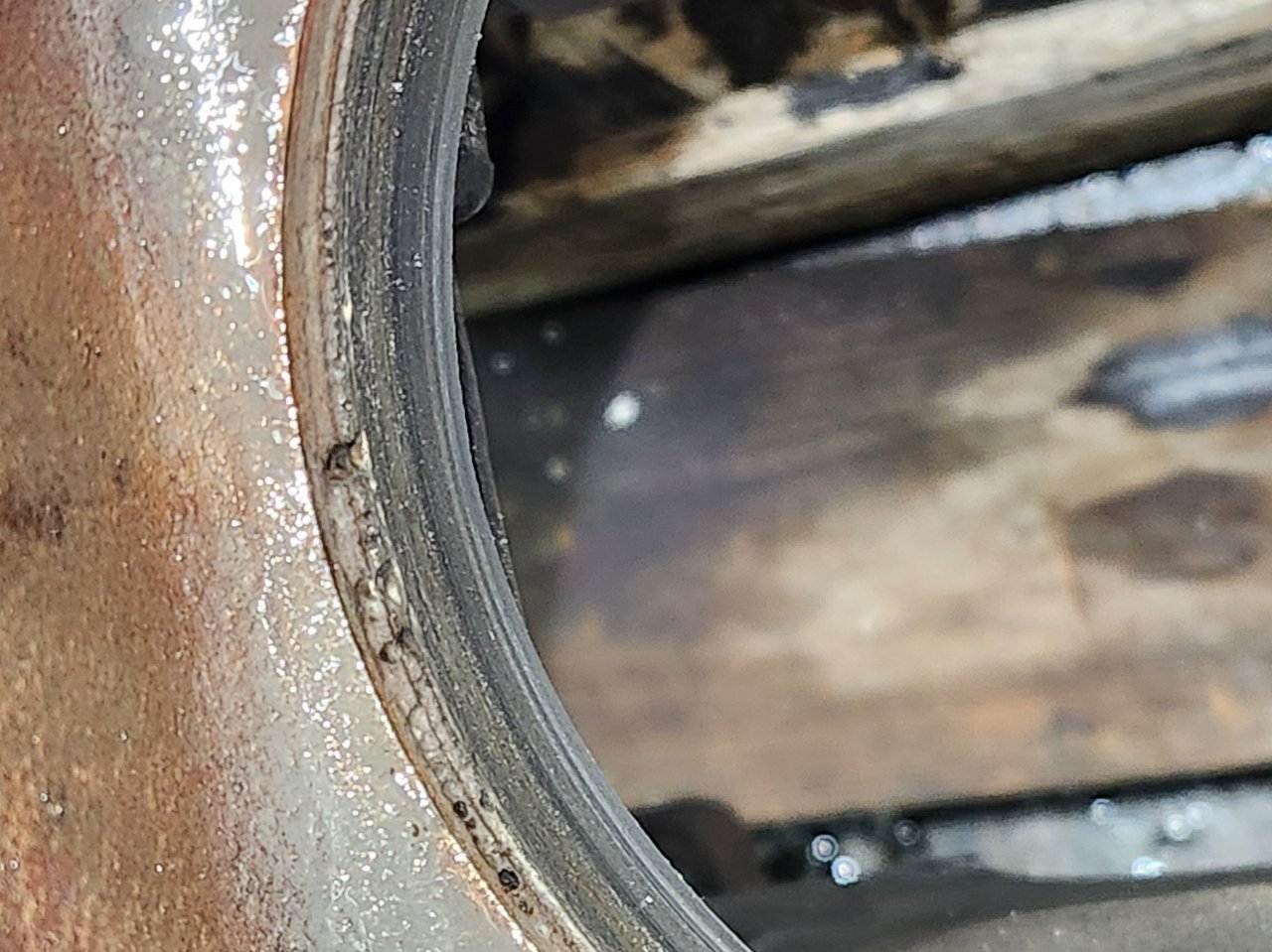

    My biggest concern on the lower bores is some erosion where the top o-ring rests in the bevel.
    The bores themselves don't look bad to me. You can just feel where the o-rings rested on some, but not all.
  11. Oxbow
    Oxbow Road Train Member
    13,881
    144,533
    Nov 24, 2015
    The deck has been counterbored before. Holes 2 through six all had one shim on, and the depth of the counterbore varied between .026 and .031(rough measurement using a micrometer). Hole #1 was deeper at .061, and that liner had two shims on it. I understand that that is a no no as you should be able to order single shims up to what you need.
    #1
