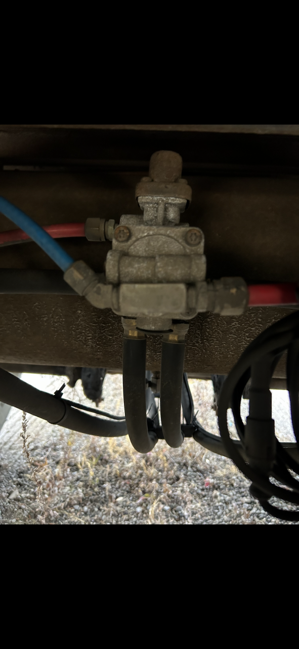

    Here is a picture of the valve on my trailer, my trailer is a 2018 so it may be different from yours. 20230316_174534.jpg

    658B76D4-280A-4582-8A9E-76AC59C98C6D.png Here’s mine. It started leaking around the top hat looking thing. Whole suspension would lose air while sitting. Wouldn’t air up without beating on it. Once replaced, it stays put in the dock.
