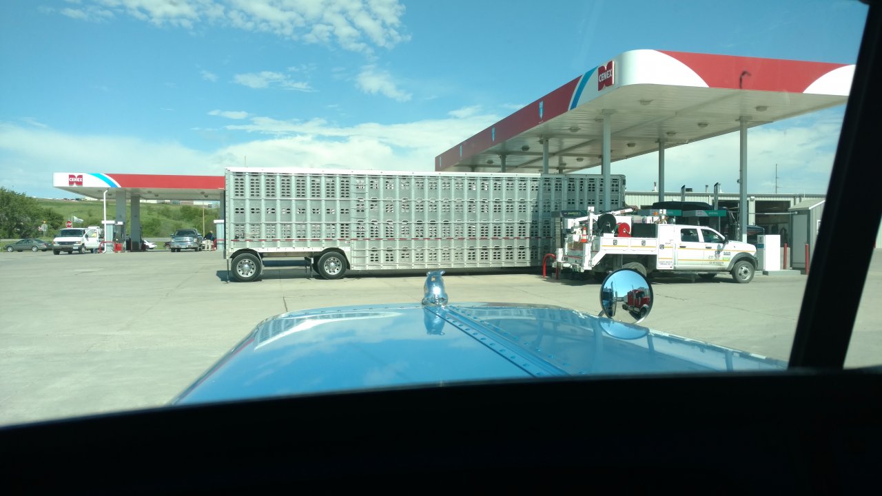

    Yeah dragging these 52footers are a real pain.... sarcasm.... 14957249579011252537825.jpg
    snowman_w900, Ruthless, MJ1657 and 3 others Thank this.

    I can see a use for a 53 ft spread axle double drop with the axles all the way back......obviously to get a longer well. I was talking about the uses for a 53 ft spread axle step deck or flat. Question on the cattle pot.....what's a typical weight on the trailer axles?

    Don't ya know a real bullhauler never crossed a scale on purpose.
    No I really only haul hogs and am rarely over weight. On 5 axles with the spread axle trailer I can go 86000 Iowa, 85500(I think, maybe just 85000) Nebraska, Minnesota is only 80,000 unless on 6 axles. South Dakota is 86000 I'm sure. Those weights are good on any road except the interstate. Iowa won't allow us at all on interstate over 80,000. Most other states you can buy an annual and run the big road.
    I think the whole weight thing is completely screwed up. 5 axles with spread I can go 86000. Throw a pusher axle on the truck I can only 87500(I think). So spend a few thousand putting on a extra axle and only gain maybe a thousand pounds payload after the added weight. 7 axles is good to 96,000 I believe.
