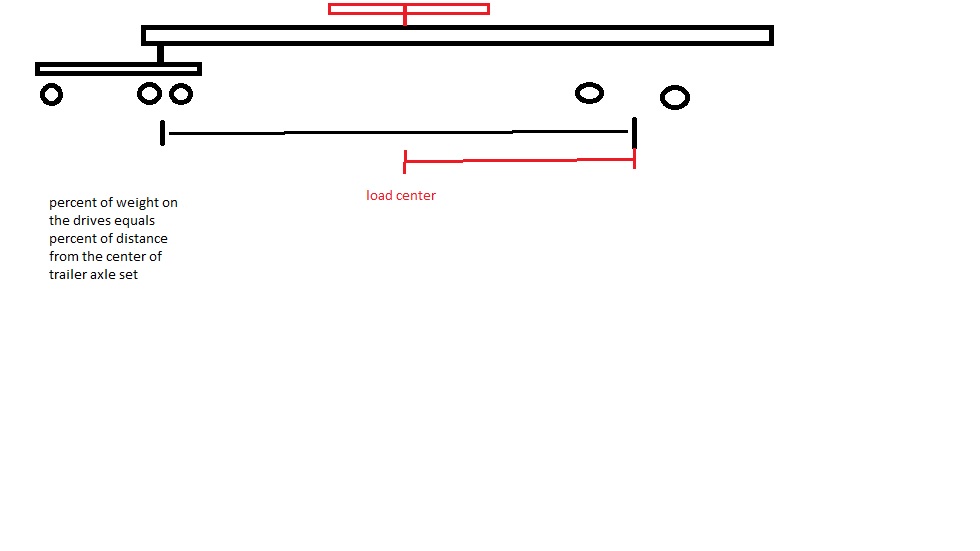

  6. beastr123
    beastr123 Road Train Member
    2,964
    24,339
    Jan 2, 2014
    Moose Jaw SK CAN
    MATH TRICK
    measure the distance between kingpin and CENTER of the spread
    then axle-weigh the unit
    subtract the tare weight from 80,000 to get max load (g)
    subtract drive axle weight from 33,500 to get max load on drives (d)
    divide (d) by (g) to get a percentage expressed as a decimal
    multiply the distance (kingpin to axle center) by this decimal
    the result is the distance from axle center forward
    example:
    kingpin to axle center measures 41 feet
    unit axle weights 12000 steer
    10200 drives
    9300 trailer axles
    80000- 31500=48500 load weight
    33500-10200=23300 max drive weight
    23300 divided by 48500 = .4804
    41 feet X.4804 = 19.69 feet

    Just not sure why you wouldn’t just measure form the kingpin to the center of the rear axle group and mark that as center?
    If you want to get technical figure out the percentage of your max bet payload that can go on your drives plus steers
    Then divide that by the total net and multiple that percentage by the length from the king pin to center of rear axle group and mark that distance as center of weight.
